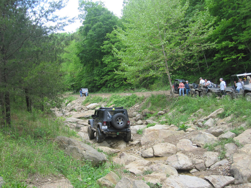

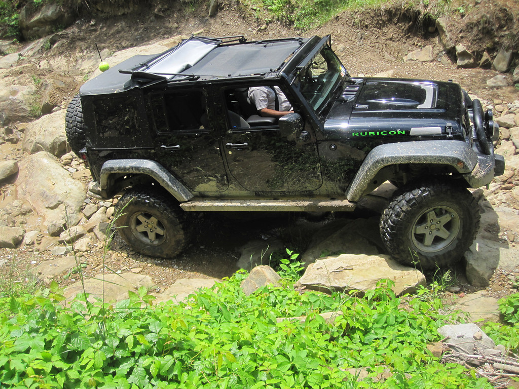

Last weekend we took 6 rigs out to Black Mountain in Harlan, KY. I wheeled Saturday in stuff like this:
I certainly wasn't taking it easy, but I wouldn't describe myself as someone who is hard on their equipment either.

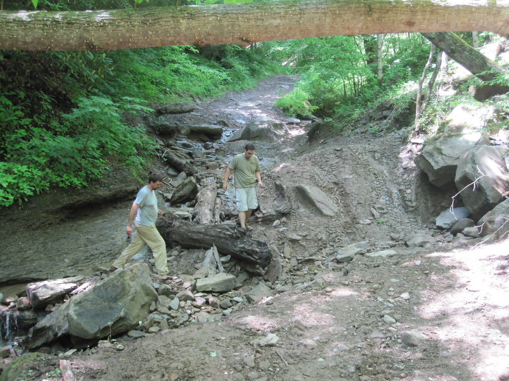

Sunday, we had a smaller group that went out and did some things like this (for those of you that know Harlan, we did Railbed and Fish Fossil. No red trails)

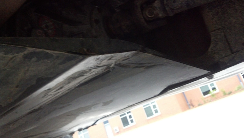

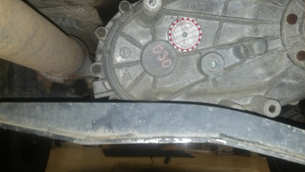

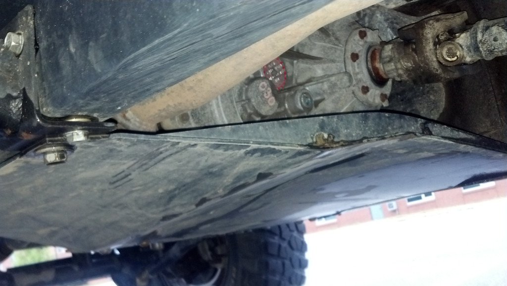

I get back Sunday evening and crawl under the Jeep to find this:
I was pretty shocked to see this. Obviously, I got on the skids, but I didn't recall any "big" hits or anything that should have done that kind of damage. I asked the 2 guys I was riding with and neither of them could recall anything memorable either.
I got home, took the pics and sent a link of the gallery to River Raider.

Here are the pics of the bent skid. Pardon how dirty the Jeep is. I got back Monday and it's been raining here in NC. I just rinsed it off and took the pics. If there are any other pics you need or want, let me know.

Looks to me like you got the "just right" hit that bends the crap out of something.
But I know I've bent things worse than that without noticing, and had bone jarring, teeth rattling hits that I swore broke everything and then I get out and no damage at all.
I think it's closer to the saying "pay to play" that applies here. Maybe they could have done a little better on customer support, but I can't think of any company that would replace it no questions asked. Skids are meant to get hit, and if they get hit, they bend, they keep something more expensive/critical from taking that hit.
Good luck, but I'd try and bang it back flat, of course if it's super easy to bend, THEN you have a problem, and I'd contact them again. but I bet you can wail on that thing and it won't bend much at all.

ain't 3/16ths a tad thin for something that weighs in excess of 4,000 pounds?The stock skid on my Willys was just a little thinner than that and as little as Nellie weighs,I rolled that skid plate like a piece of aluminum foil.I believe you might have hit a rock with a more glancing blow while going foreward and the force would have transfered along the frame moreso than a jaring hit straight down.I fixed my skid issues by hammering out the original skid and then plating the bottom with a flat piece if 3/8ths.
This is a tough situation. I'd say that 3/16 is a little thin, especially in an application where its basically a flat plate with a few ribs on the top side. You'd be better of to have sacrificed 1.5" of ground clearance to have a broken edge all the way around to actually make it like a pan then add a few ribs that run side to side inside it. A lot of times companies like that are looking more at profit margin vs. quality. 3/16 is cheaper than 1/4 by a good bit and it's cheaper for you to have shipped which makes it easier for them to sell. I'm not saying it's a bad product just that it's probably built to sell more than it's built to work, and will probably do just that.
If I were them I'd have a hard time wanting to replace it for you based on the information you've posted here. It isn't necessessarily a great design and they probably know that. They also probably know pretty well what it will actually take to bend it. I'm not trying to discredit your story, but in the pictures you posted you can actually see a white spot right in the middle of the bent area. That typically is a tell tale sign of an impact with a rock or at least where you dragged really hard on a rock. Then at the very back lip of the pan it looks like you can actually see that the edge of the metal is deformed around that same rock, almost like it scraped away metal. That takes pretty substantial force. You may not have felt it, but it's pretty obvious that it did happen some time or another. My guess would be that it probably happened in pic three. It looks like both axles are unloaded and the belly is dragging right across that ledge. That picture probably sealed your fate in having any luck getting it replaced.
I think your best bet would be to cut your losses with it and have your local vendor build a pan that is taylored to your vehicle and driving style.

From what I can tell, it's not even fully welded across the bracing.

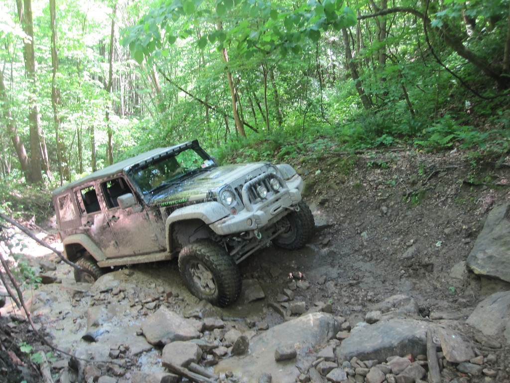

That pic wasn't bad. It was just packed dirt and it was flat across the top. The jeep was resting on the skidS and the frame rails.
Chris, you're right, you can see where a rock struck the skid. It just seems like I'd notice a blow big enough to do that kind of damage.
It won't take a hard hit to do that. More than likely just laying on the pan like that and driving off of it would cause that damage. You can clearly see that the pan is bent in the picture I posted earlier. When that pan is new it should be level with the ground for the most part as you can see here....
In this image you can can clearly see that it's bent up substantially in the rear.....

While it did bend, I'd say it also did it's job of protecting your t-case. Your jeep weighs roughly 4300lbs. That is a bunch of weight resting on the skid, not to mention the force put on it when you broke over that dirt pile and landed on the skid.
I'm not really trying to give you a hard time. Being that I'm a builder of parts similar to these but on a smaller scale I really hate to see guys do exactly what you are doing. You say "I'm not going to go out and bad mouth River Raider" but you just posted this on the internet in a thread titled Jeep JK River Raider skids. If anybody goes on the net searching for information trying to make a decision whether to buy these skids or not they'll probably find this thread. That can really hurt a company. For someone as small as me that could be detrimental to my business. Word (especially bad word) travels fast.
3/16 steel IS a bit thin for a skid plate on a vehicle that actually does see some rocks. Knowing that in the future will help you make a decision when you replace this one. Fortunately for them they clearly state that it's made from 3/16 on their site, if they hadn't this whole issue would be a little different story. You can't really claim that it's made form inadequate materials and even if you could you bought it knowing what it was made of.

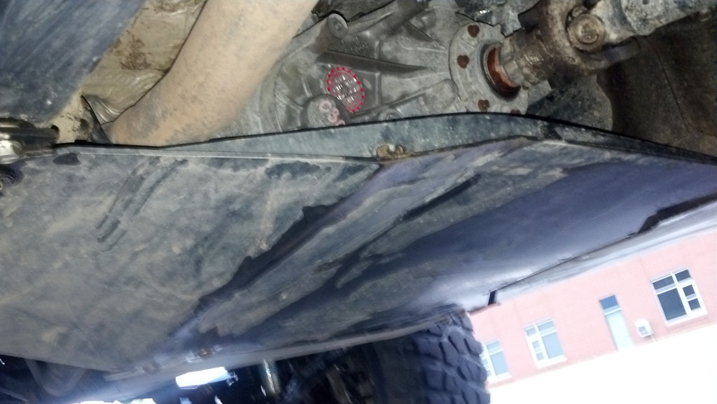

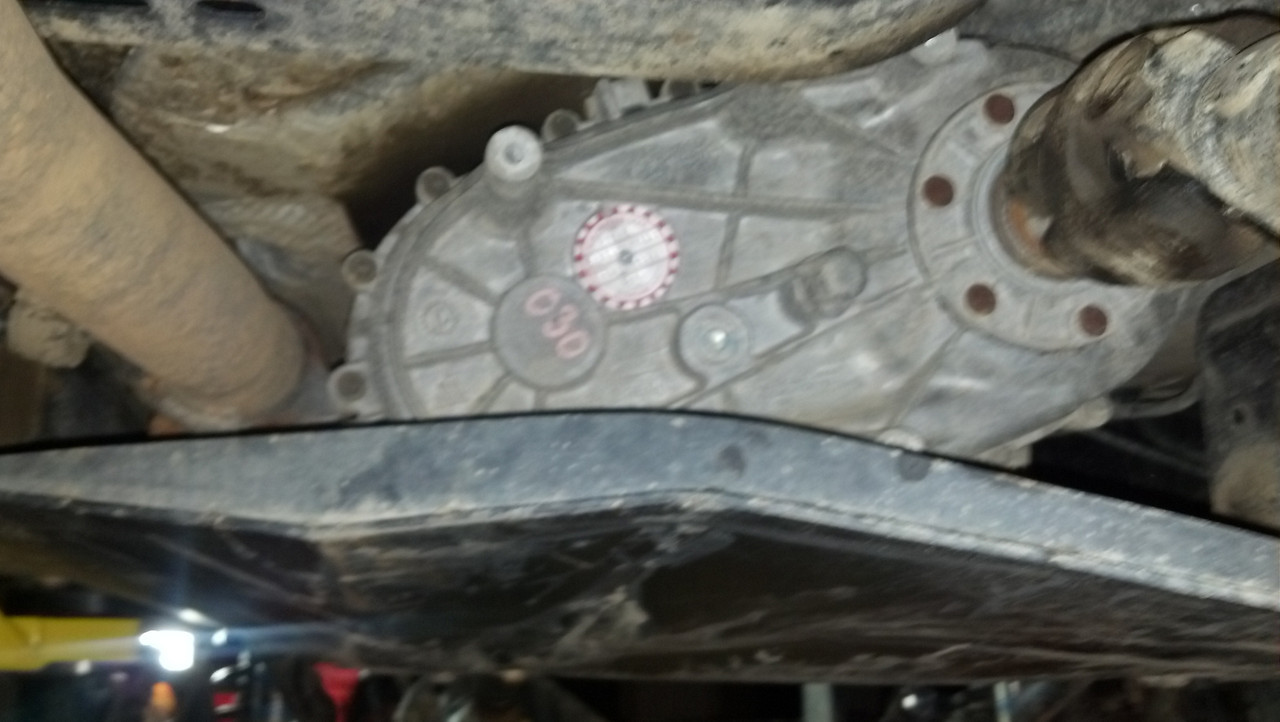

I took the Jeep to a buddys shop last night and put it on the lift to get a better look. The skid is on the TC. the transfer case appears to be what stopped the skid from bending further.
I'm no engineer or fabricator but the back section of the TC case skid goes from the frame rail on the driver's side to the gas tank with very little support. It's right in the center of the undercarriage where it seems to be susceptible to a lot of hits.
