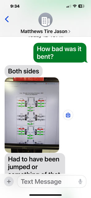

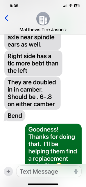

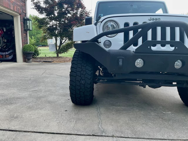

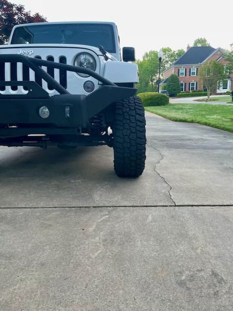

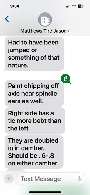

One of my customer's sons has '15 JKU. It was towed behind an RV for the first part of it's life, 45K now. It has 31's so they say but I think they are bigger. NO LIFT. I've always thought the front springs are trashed because it's low in front. Dad says it leans left but their driveway is tilted so I've not paid attn to that., but front end noticeably squats. Dad took it to Rowell's of all places and they replaced front springs and tried to align it and said it wouldn't align. Said sway bar may also be bad but inconclusive. They said it needs a new front axle/diff without giving a reason other than it would not align.
I told them when they got it that it needs a budget lift to square it up. So now they're wanting a second opinion because they don't trust Rowell's. I've not looked real hard at it because my Jeeps are '56 and '68 so my tech advice is archaic.
