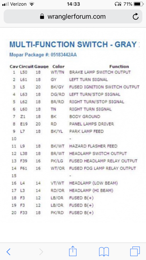

Fixed, kinda. Had to get a smart person to look at it.
For anyone that turns this thread up when trying to fix a similar issue, mine ended up being wire 11 in the multifunction switch harness. I believe it is shorted somewhere. When testing, it had the wrong polarity. I have not yet gone through the wiring to find where it is bad, but have simply run a new wire with an inline fuse that goes to an ignition switch controlled power source.
We found this image quite helpful while diagnosing the issue.
