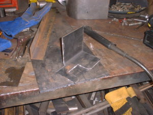

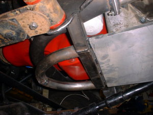

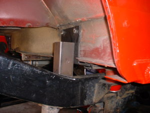

Not much to say, got the B piller tied into the frame. Plates bolt on to the foot of the main bar inside. As seen outsite..

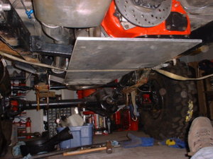

Started skid plate. Got front brace done, and cut alum. need to drill some holes and make the back brace...
Got a few other small items done, making progress...

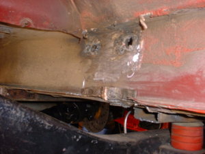

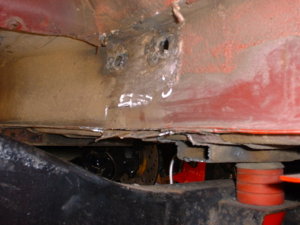

and a few more for hobie who was interested to see how i did the ties ins..
Basically i cut off the stock welded on nuts, notched the tub a bit. Trimed the ONLY the upper part off, folded the bottom part up.
Made brackets as seen, drill holes to fit, bolted on and welded...
