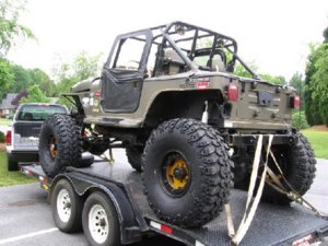

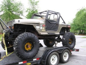

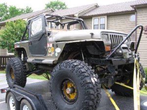

finally got the piece off the jackstands after a 2 month hiatous.
42 x14 x 16.5 iroks on recentered hummer double beadlocks w/ 5.5 inch backspacing
i wanted to narrow my jeep up a little and take some stress off the knuckles and bearings blah blah blah. it turned out ok.
next is figuring out the winch delema and losing more weight. the windshield was removed and the rear bumper trimmed up to lose some weight, but she is still a porker.
anyway, just thought i would share.... :flipoff2:

Gonna get kind of windy/dusty in the cab there isn't it? Looks, uh, really big.
i am gonna put plexiglass in for a windshield if i ever get around to it. been moving very slowly on it...
Plexiglass or Lexan? Plexiglass is much cheaper, but will break if hit by a rock or the like. Lexan won't. When I bought my lexan, it was $235 for a 4x8 sheet. Got two windshields out of it though so I guess $117 isn't too bad for a windshield.
