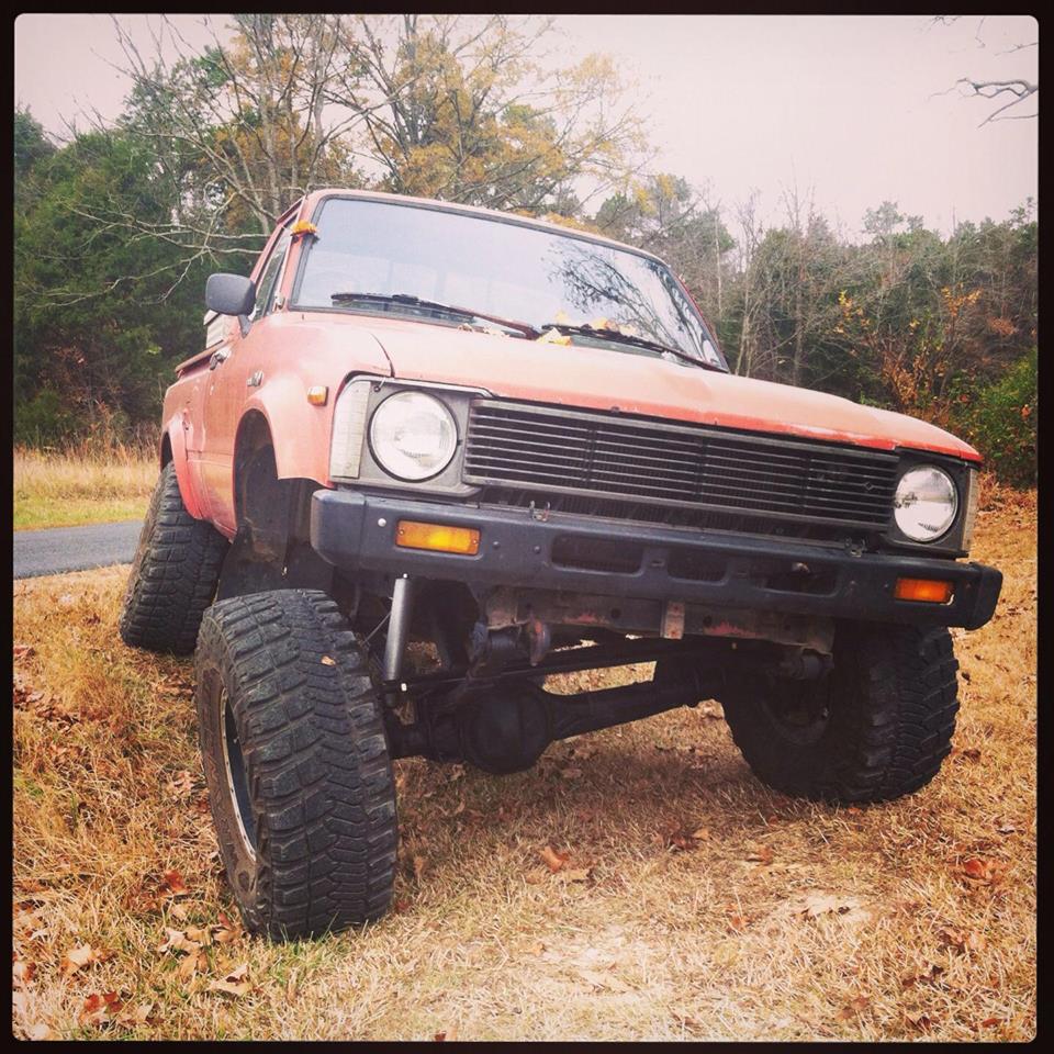

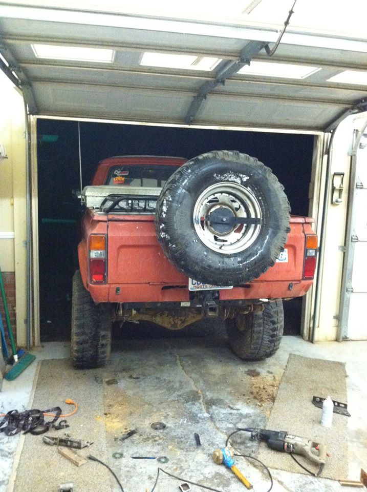

Current:
afbcdn_sphotos_a_a.akamaihd.net_hphotos_ak_prn2_t1_1454845_706089312735895_626275796_n.jpg
Specs:
1982 toyota pickup
223k miles
22R with toyota carb
5speed
4wd
Suspension:
Front:
RUF (Rear springs up front w/AAL)
Sky Banana Shackles
Trail-Gear Brake Lines
Rough Country 2.0 Shocks
Trail-Gear Ubolt Flips
Trail-Gear Hi-steer kit
Rear:
5.5" Trail-Gear shackles
2" block
Wheels and Tires:
15x8 Eagle Alloy 185
33x12.50R15 Goodyear MTR W/ Kevlar
Misc:
Lock Right front locker
Welded Rear
79 round headlight swap
4.7:1 Transfercase gears

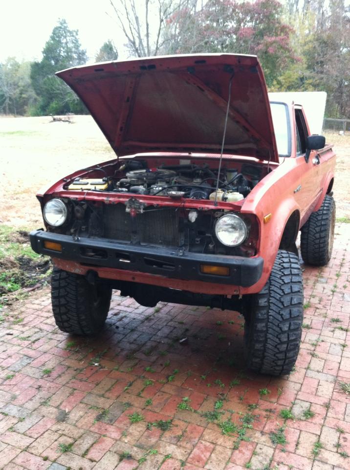

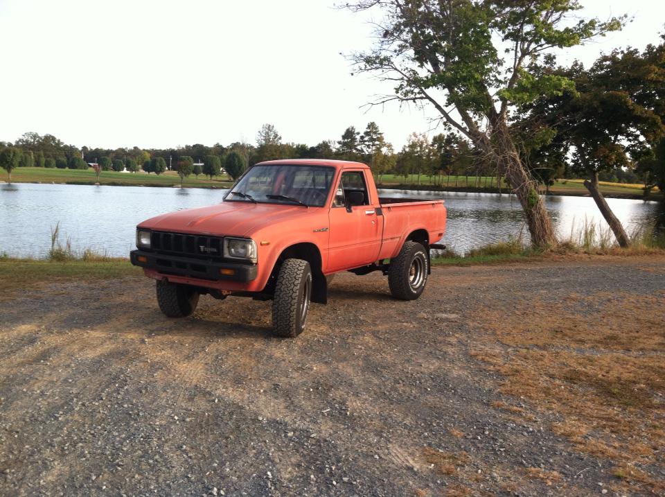

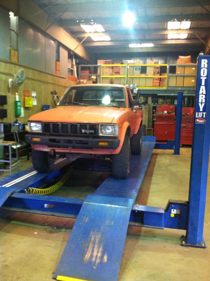

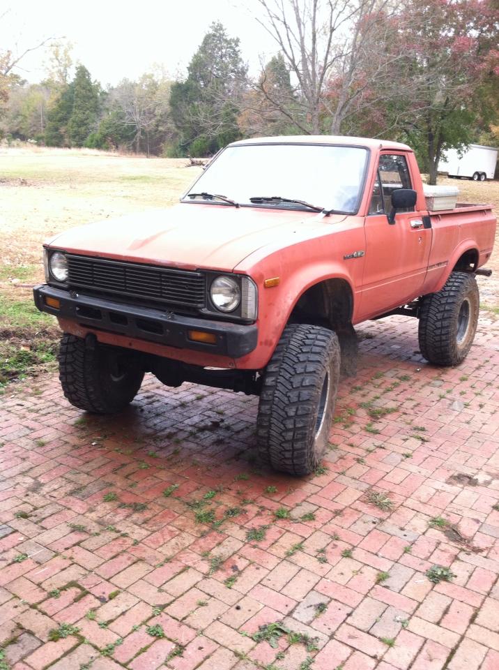

The Day I brought it home, also nicknamed it "The Date Truck"

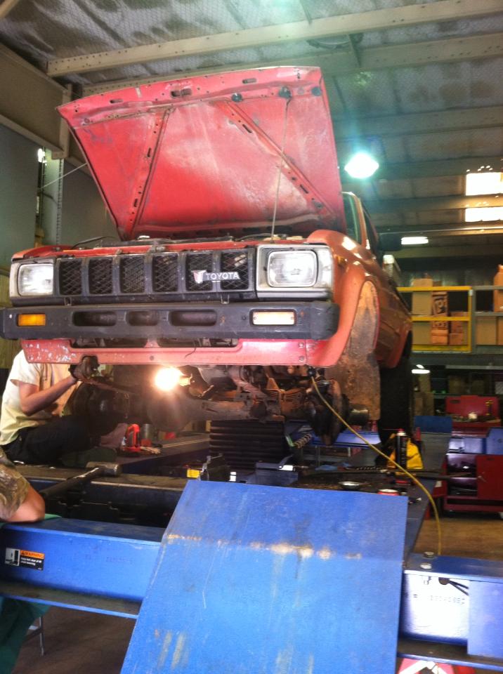

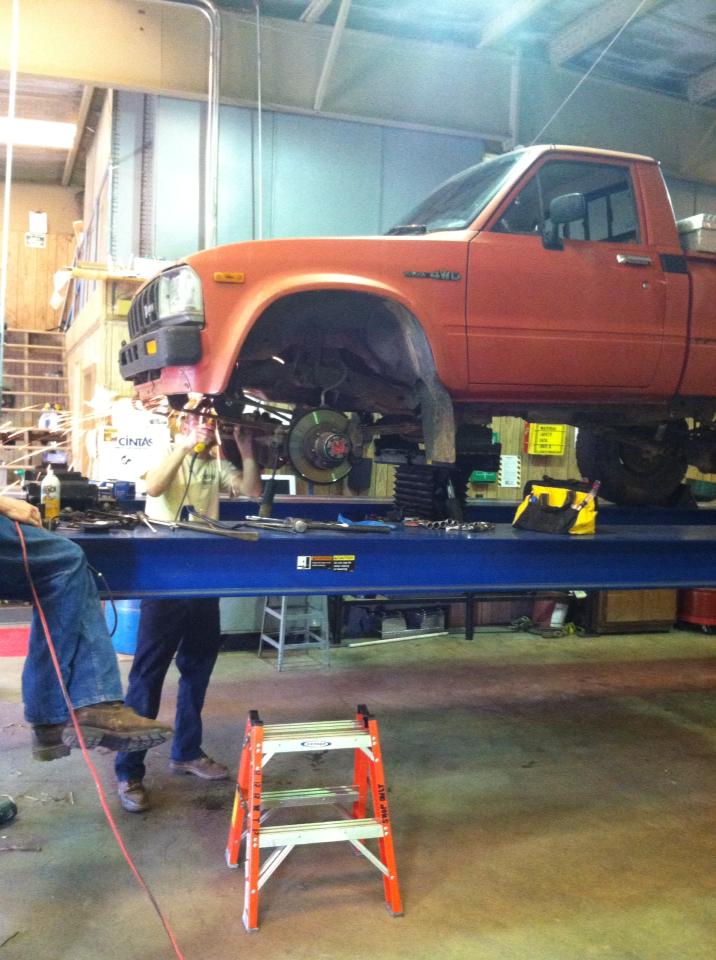

Whats the rest of the plans on this one Jerret.

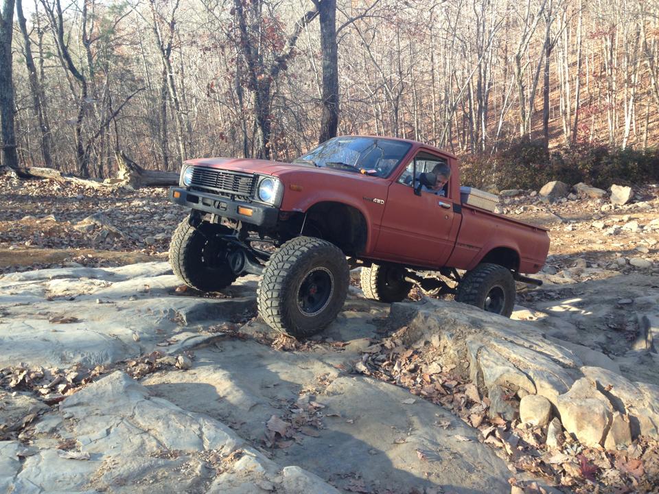

Im wanting to keep it simple, yet effective. For sure future plans are 4.70 transfercase gears, and a spartan or lock rite front locker. Planning to do some misc things like clutch, and some lighting upgrades. thats basically it, I am happy with the suspension so far, and all the current modifications seem to be doing great.
Love this build. Nice truck. Wish I would have never sold my 83
Nice first gen! I just picked up an 81 that I'll be building slowly...

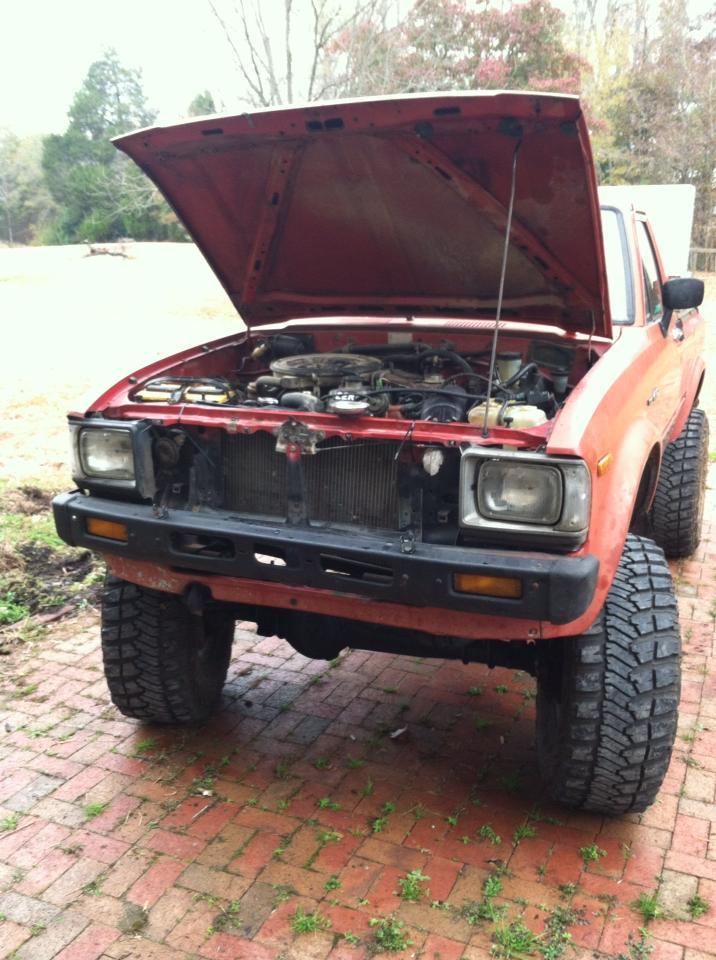

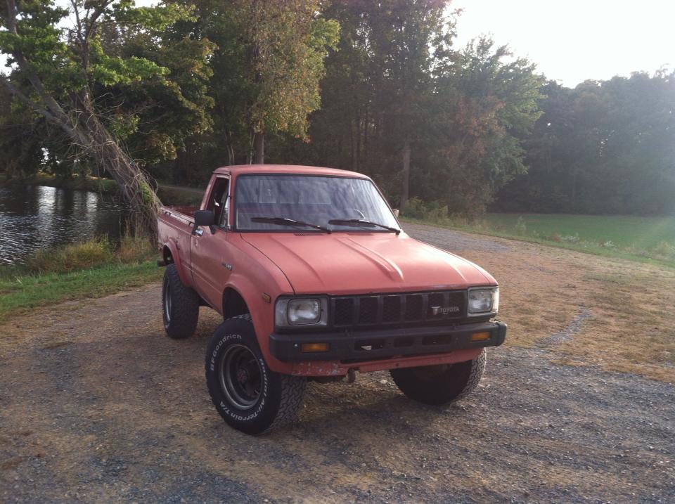

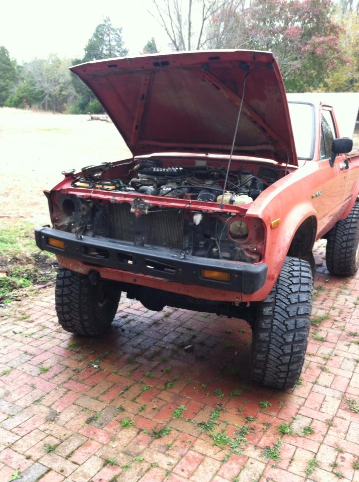

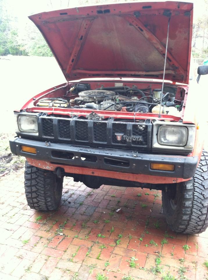

So I see you swapped grills, what happened to the original grill, for sale? Nice build, good seeing a Toyota born in 1982 still getting out on the trails.
