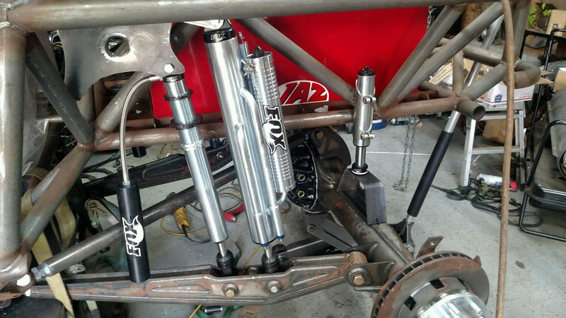

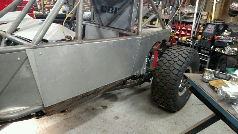

I started this build a few years back and took longer than I an anticipated, which is ok. There were some changed along the way.
Here are some pictures along the way and some more that I need to get off of my phone.
Specs:
Front Axle:
TG Housing
609
Howe / PSC steering
Gear Works Hi 10, 5.43, spool, 1480 yoke
RCV 300m
Rear Axle:
TG Housing
Double spline RCV 300m
Rear spindles are bolt for easy change
Gear Works Hi 10, 5.43, Spool
Engine:
LS 416 forged, 13.1 compression
Trans:
4l80 MVB
T-Case:
Hero 3 speed
Suspension:
Fox Suspension
4 link, rear Campbell / Ruffstuff tailing arms
