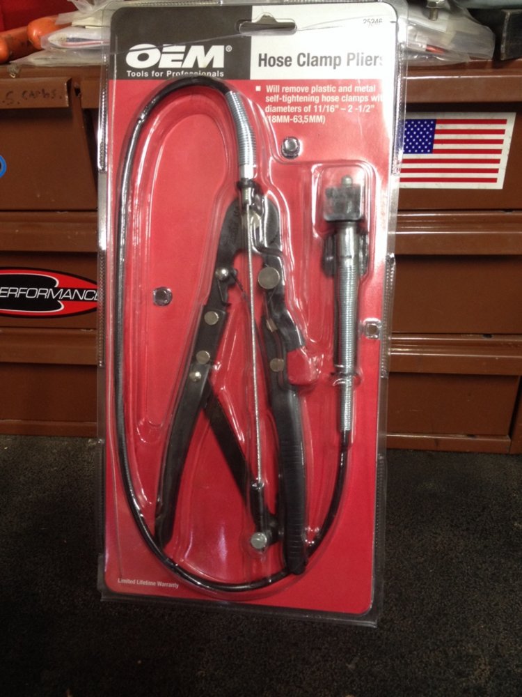

Anybody have any suggestions on the best way to replace these? I can't get my fat hands back in there and it just pisses me off. The factory clamps are facing down, which just makes it harder.

You will want one of these tools.....
Well, got em done. There ain't shit on the Internet about this job, so I'm assuming nobody is doing them yet. I'm a maintenance dude so hose have to be done BEFORE there is a problem. Ended up removing the upper intake, which enabled me to get to everything. Removed the passenger side tire and splash shield to access the EGR tube lower bolts. Even with all that they're still a PIA.
