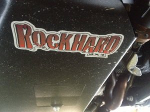

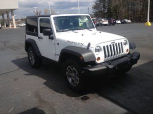

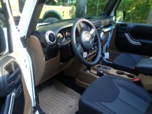

On February 16, 2013 we ordered this White Rubicon. It arrived at the dealer on March 19, 2013. Since that time we have been making some modifications as follows:

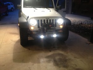

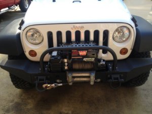

1. Rugged Ridge full width Front bumper and front skid plate (Craigslist buy Corbin Ky)
2. Warn 9.5 Powerplant winch (craigslist buy Corbin Ky)
3. Best top High Rock Rear Bumper w/ tire carrier, Cb ant mount, High Lift Mount, Fire Extinguisher mount (A great design and form fitting) (4WD Hardware)

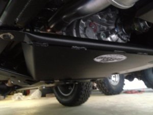

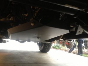

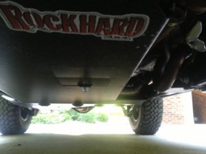

4. Rock Hard skid plates for the evapo canister, oil pan, transmission, and transfer case (very strong and great support) (4WD Hardware)
5. Ace Engineering Rock Rails (Ace)
6. Weathertec floor mats (Quadratec)

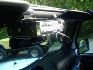

7. Zebra overhead CB mount
8. Uniden PC68 Cb (from stock)
9. Wilson 5000 Antenna (Humble Electronics)

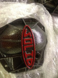

10. Solid Dana 44 Diff Covers (Solid axle)
11. 4 American racing Polished al Outlaw wheels 15 inch 3.75 BS
12 4 Falken Wildpeak AT 35x12.5x15 mounted on wheels (JK forum buy Atlanta..tires and wheels had 2500 miles on them)

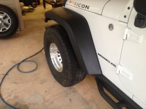

Future Modifications may include a set of flat flares and/or chromolly front axle shafts. The flares will depend on how the 35's work with the stock flares, either way all must be complete by August, since we will be driving the Jeep out to CA for the Jamboree at the Rubicon.

And Thankyou very much for helping me get my cb set up and installed, it,s workin great, already kept me out of a traffic jam on the interstate!
Good glad it is working well.
