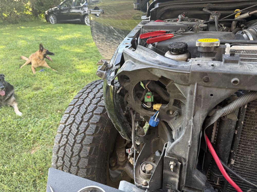

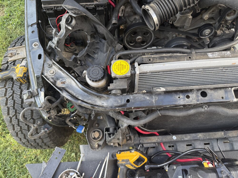

Stepson hit a deer in the 2010 JKU, trying not to submit to insurance so doing a driveway repair.
Is it posible to get, and/or replace just the passenger plastic part of the radiator support? Or do I need to pull and replace the entire thing? I can't see any obvious damage on the metal parts. The headlight was pushed back and broken is all....

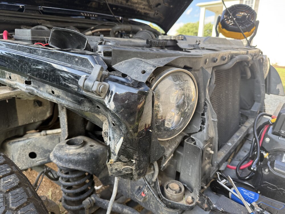

Radiator itself is fine, just the support plastic part that holds the headlight is wrecked. And fender, and grille.

Back to the damaged bracket. I'd say you have a few options:
1. You may be able to find the obscure part number and order it from eBay, Amazon, or parts dealer
2. See if a junkyard has a JK you can pick and pull it off of
3. Frankenfix it with epoxy and some reinforcing brackets
4. See if it is 3D printable

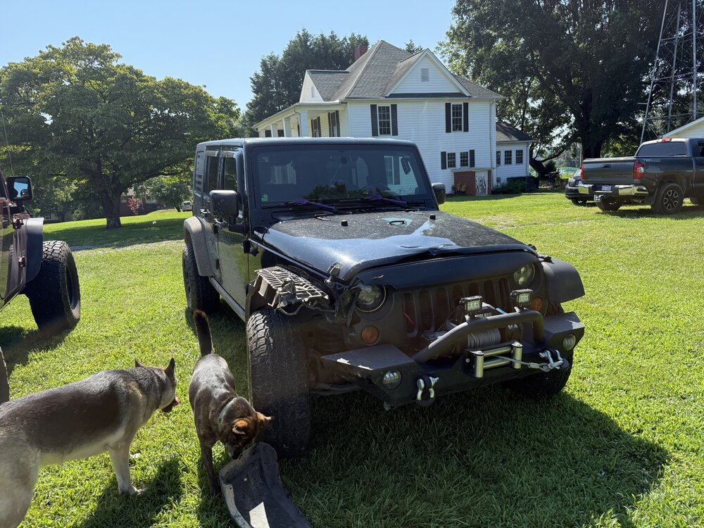

I sourced a core support locally and threw that in, waiting for him to decide if he wants to pay for flat style plastic or just get one from a yard. Pulled the current fender with the winch on the SXS
Go flats.. I've had a set of slim fenders sitting in my garage for the last three years. I keep thinking I'll get around to installing them. The reality is I will mount them when I manage to rip a stock fender off while wheeling.
