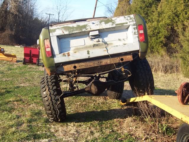

After a long while of gathering parts, we finally got some work accomplished on a buddies scout...

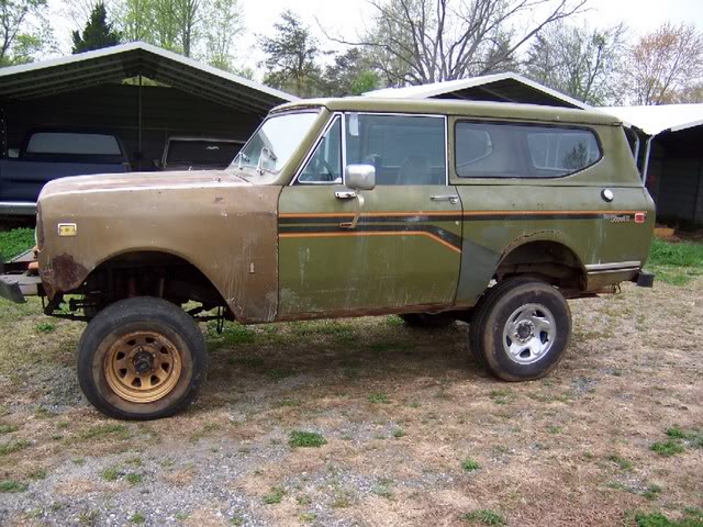

As it wheeled in, with SOA, 4" blocks and worn out stock springs, and a bunch of rust

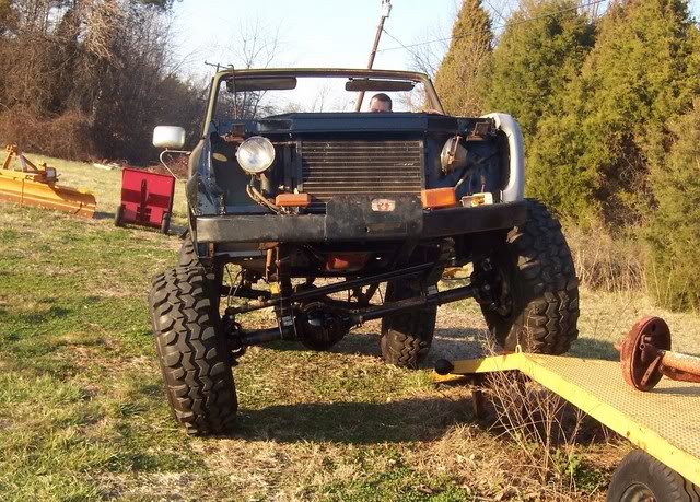

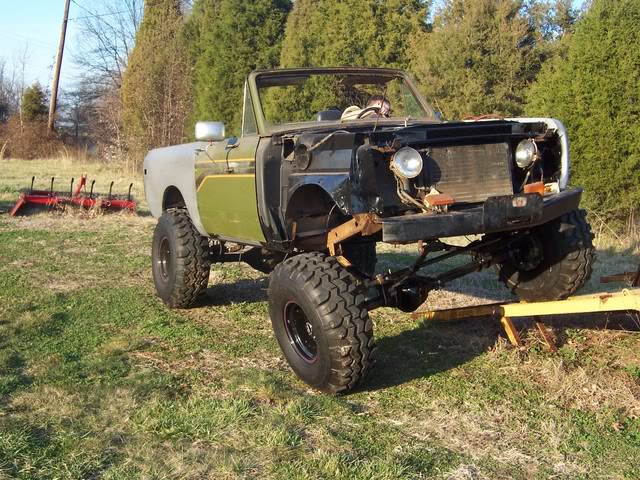

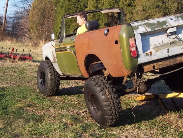

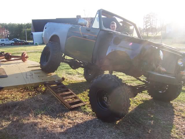

Just finished up a SOA the right way, with new Traingle springs... & 36" TSLs
Front has a GM D44, 4.10s, Powerlock, knuckles turned & pinion tipped, high steer.... 4" lift springs with leafs removed and stock shackles
Rear has a FF D60, with 4.10s, 4" lift springs with leafs removed, and 2" lift shackles
This is just a lil testin on the susp for clearence... still has a lil stuff to finish in the front (brakes, driveshaft)
Maybe Adam will chime in if i forgot anything...
