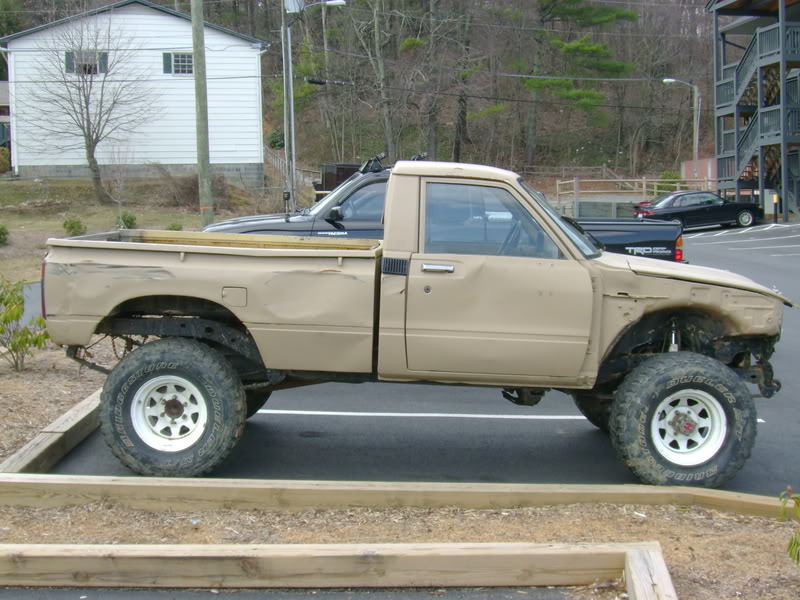

I wont quit wheelin, but I wont tear up my DD at the same time...sooooo...I picked this up once the opportunity presented itself.
Currently...an 1980 LWB Pickup with a bobbed bed, no fenders and a blown 20r. The motor is being replaced with a 20r from BJACK that I will be picking up tomorrow.

After 2 hard weekends of work shes ready for Harlan. We got the motors swapped last weekend and spent this weekend figuring out the charging and starting problems as well as welding the rear and adjusting the lash which was pretty bad. Figured out that it had 4.38 gears instead of the 4.10's.
Also got a nice cowbell hanging from the front bumper.

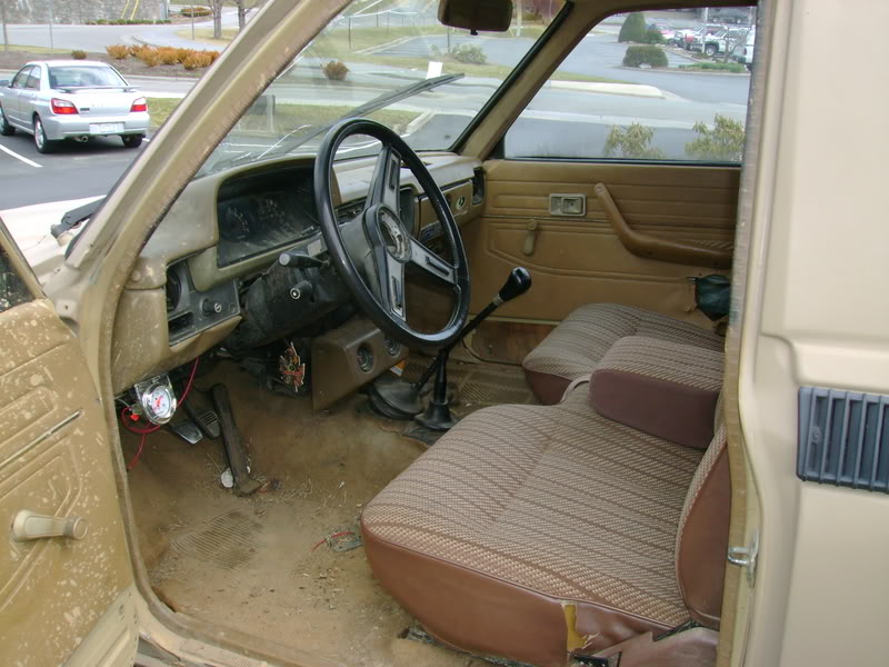

Pics from last night...note DP's artwork (probably wont stay haha)

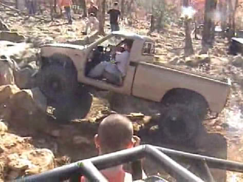

It ran Mason Jar really well but it was all skinny pedal, otherwise it wouldnt have made some of those ledges.
