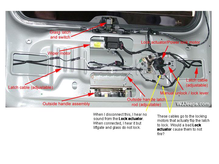

Yeah there really easy to change I changed both fronts in ours not too long along. But now I have to figure out why the heck the rear hatch wont unlock and open. That will not be fun.

Lock actuator...not too hard to replace. They go out in the doors pretty frequently too.

For what it's worth, I found you a pic to get you started.

I ordered one already. Will remember this for future repairs.
