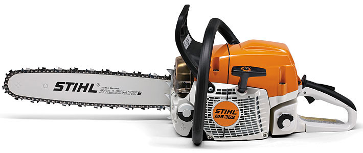

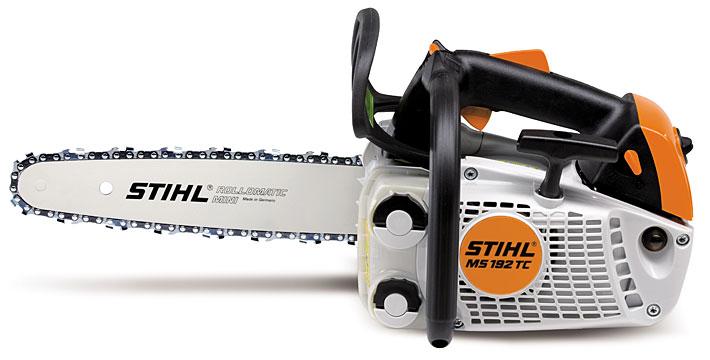

Where else would the handles placed?
Behind, instead of on top. Top handles are more nimble, but have less leverage because the distance is shorter. I've never used one, I just think they're cool.

They are made for using one handed in a bucket truck, where you are working below the top of the bucket, and there's a fiberglass barrier between you and the saw. I loved using mine in the bucket truck, and hate using it on the ground. As @Fabrik8 said, the distance between the wrap handle and the trigger grip are too close, which drastically reduces your ability to control the bar, and greatly increases the likelihood of kickback and/or the saw getting away from you. Just based on the separation of the handle, you have 2 TIMES the leverage to control the saw with a conventional saw. You'll be fine if you keep those things in mind when using it, and be not an idiot.

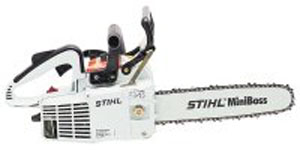

My 009 is not as top-handle-ly as the pic up above...get a little more leverage, maybe that's why it works so well....
Looks like this one:
Great little saw, I'd hunt down another like it if this one died.
