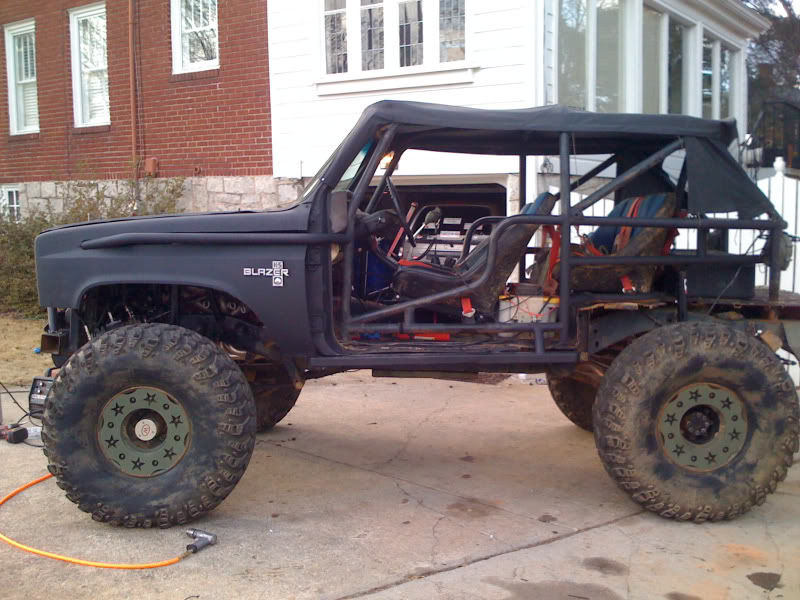

I like that!! Im leaning towards something like this with the tube behind fender possibly and semi into the dash panel depending how much patients I have...

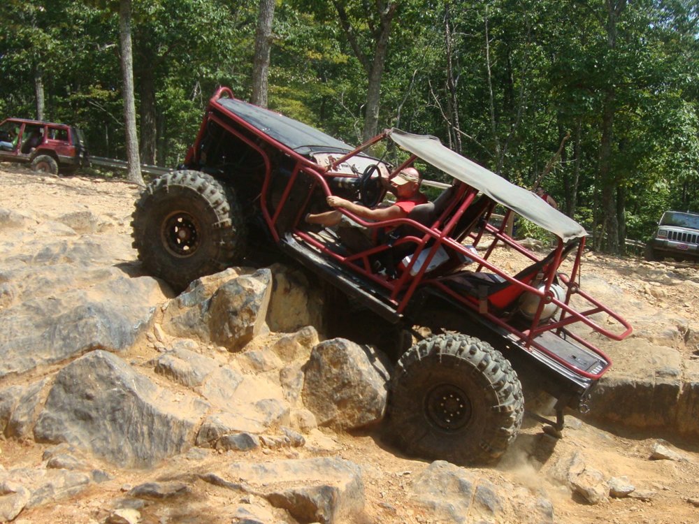

John's K5 that Pipeline posted just flat out works! One of the most flexible leaf spring rigs I've ever seen too!
56's in the front. His K5 end up like this after a trip to Harlan damaged all the body panels
