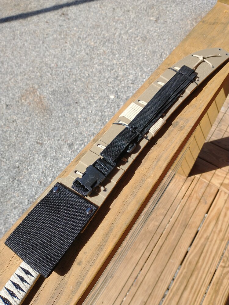

I bought this sword as it's very similar to the size and shape I've designed. The sheath is actually really nice. I couldn't make one for the price of this pkg. so I may make sure my sword fits this sheath and order a.butload of them😉
Anyway, here's the china sword I will customize and use as a pattern. It's nicer than a $40 sword should be. I'll update if I get this sword going.

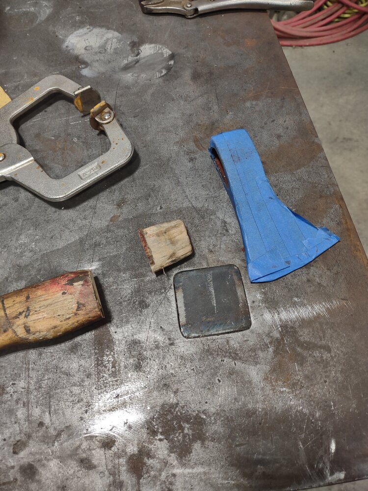

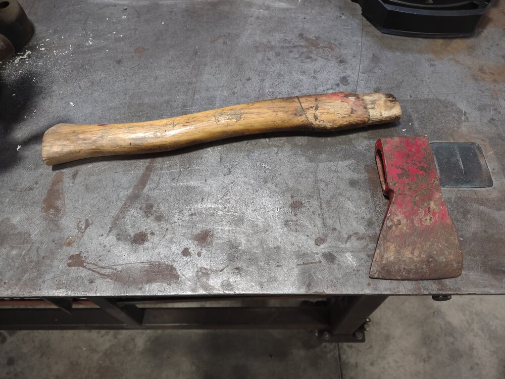

I'm all about sharp objects. So I tried my hand at repurposing a junk yard Chinese 🪓.
First step. Remove the almost half inch of epoxy on the end. No wonder the head flew off.

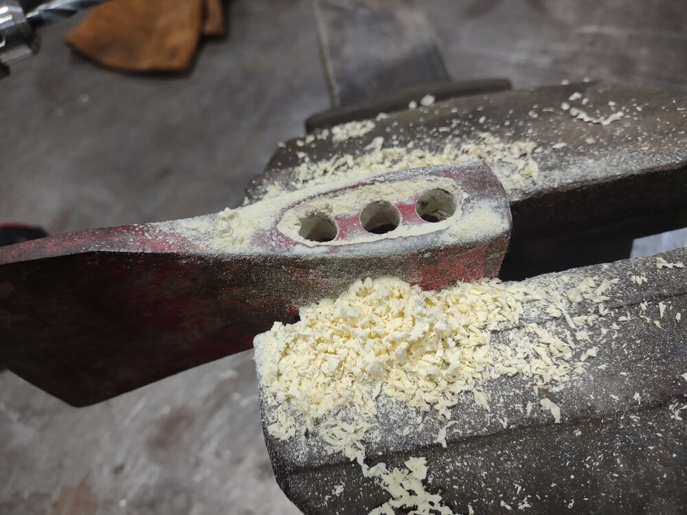

The casting isn't horrible but the inside was really rough. Dremel cleaned it up and revealed a fairly hard alloy.
Few rough layout marks and a cut of wheel latter. Like my anvil from railroad track I wanted to use everyday tools.
Plus time and patience made much less heat.
Little tape to protect all the hard work.

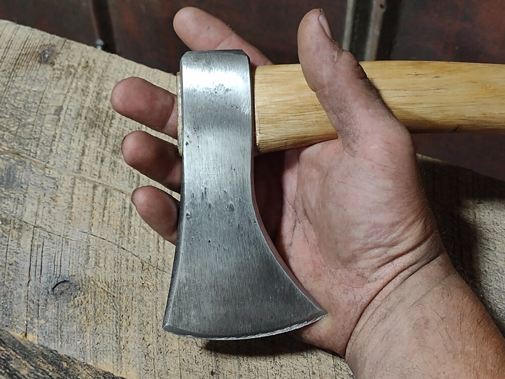

My hand for scale.
Poser pick.

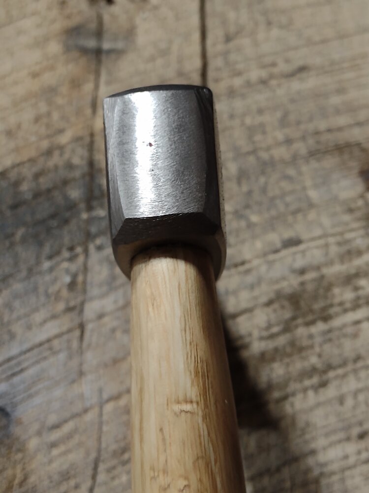

Better view of the detail of the profile. I'd love to learn metal tooling or add real forge work.IMG_20220710_211649963.jpg
Little character added to the plain cast. I like the softened edges better.
Leading taper to the tip. Aids in a slimmer look.
Glimpse at the cutting profile. I didn't want stupid thin. It's a tool first. Right?
It is however a sharp tool. I honed it sharp enough to slice notebook paper easy enough.
I tried to keep all the textures and grind marks continuous or consistent.
Symmetry ended up pretty good for all freehand and a Coors or few.
Inner edge got the same treatment. Don't hate me for the wood glue I forgot to wipe....dag nab it.
