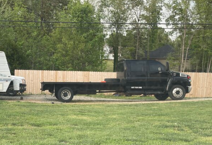

There’s a group on Facebook called Kodiak Dynasty and that’s been a wealth of knowledge for me. These trucks came from that factory with wiring issues and many quirks. It’s a lot like owning a jeep, you just learn to love its flaws. Mines fixing to go under the knife and get the rear axle moved back.

There’s a group on Facebook called Kodiak Dynasty and that’s been a wealth of knowledge for me. These trucks came from that factory with wiring issues and many quirks. It’s a lot like owning a jeep, you just learn to love its flaws. Mines fixing to go u see the knife and get the rear axle moved back.
I'm sorry did you say "back"? Is this the truck we're talking about?
:laughing:
