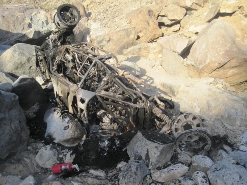

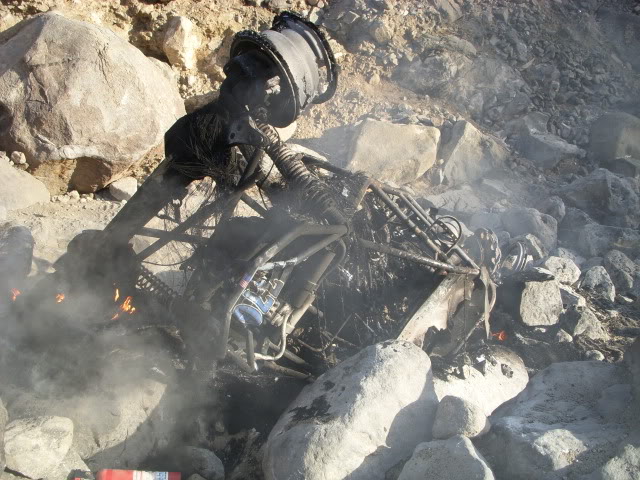

FWIW, here's a couple of pics of what was left of Mercer's cars a couple hours later, the rocks were still warm and the tires were still burning:
John

This might be a stupid question, but if the motor was behind him, and that is where the fire started, how did the rig burn that extensive all the way to the very front and reach all 4 tires and wheels? Does the powdercoat on the frame burn extremely well? What fueled the fire in the front?

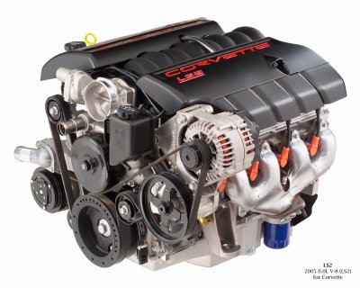

It had an LS2 in it I believe...once one gets burning, wires start buring and shorting...that's usually all it takes for one to go completely up in smoke.
