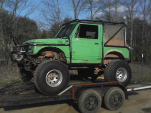

Just got through trading my 83 yota for this samurai from quickracer today. Info wagoneer dana 44's underneath both axles locked. Full inside cage and a full exo cage thanks for the great work on the exocage and mounting the winch jim. Plans for it put my 38.5 boggers and beadlocks on it, put a 6.5to one kit in the transfer case eventually chrome moly front axles.

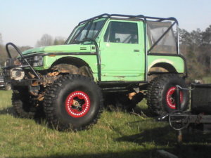

samurai stuffed with 38.5" boggers on beadlocks

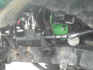

just ordered a 6.5 to 1 kit for my transfer case and have decided to go full hydro steer hope I can get all this stuff here and installed by first farm event
new goodies
7.3 orbital valve, 2.25 x 8 dual ended ram, column, and brackets ordered for full hydro set up from PSc steering. Also ordered heavy duty cradle and brakets for transfer case. All of this should be here next week so be busy week and a half leading up to the farm event.

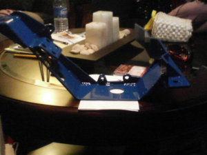

new transfer case skid plate and mounting bracket from low range off road

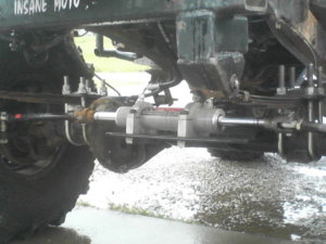

Few pics of the full hydro set up. Here is my dual ended ram.

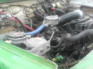

Look how nice the 1.3 looks all juiced up on propane.

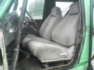

Finally went to the local body shop picked out some new seats and got them mocked up.
