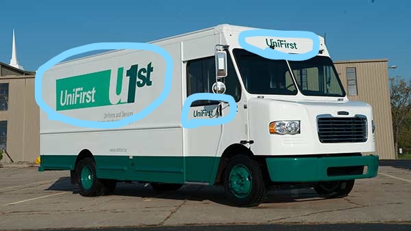

I need to remove some large decals from the side of a box van and looking for a faster alternative than a heat gun.Years ago they made a round rubber eraser looking thing that you could use on a die grinder of drill but from what I can remember they were kinda expensive and didn't last long.Any suggestions???
Pics of decals.
Get the 3M eraser wheels, seem to do better and last longer. If you hadn't tried the heat gun, that may be your fastest way. Really depends on the decal. Some are easy, some are like rock.

second the 3m wheel i got another brand and it didnt work good got the 3m and was done pretty fast
