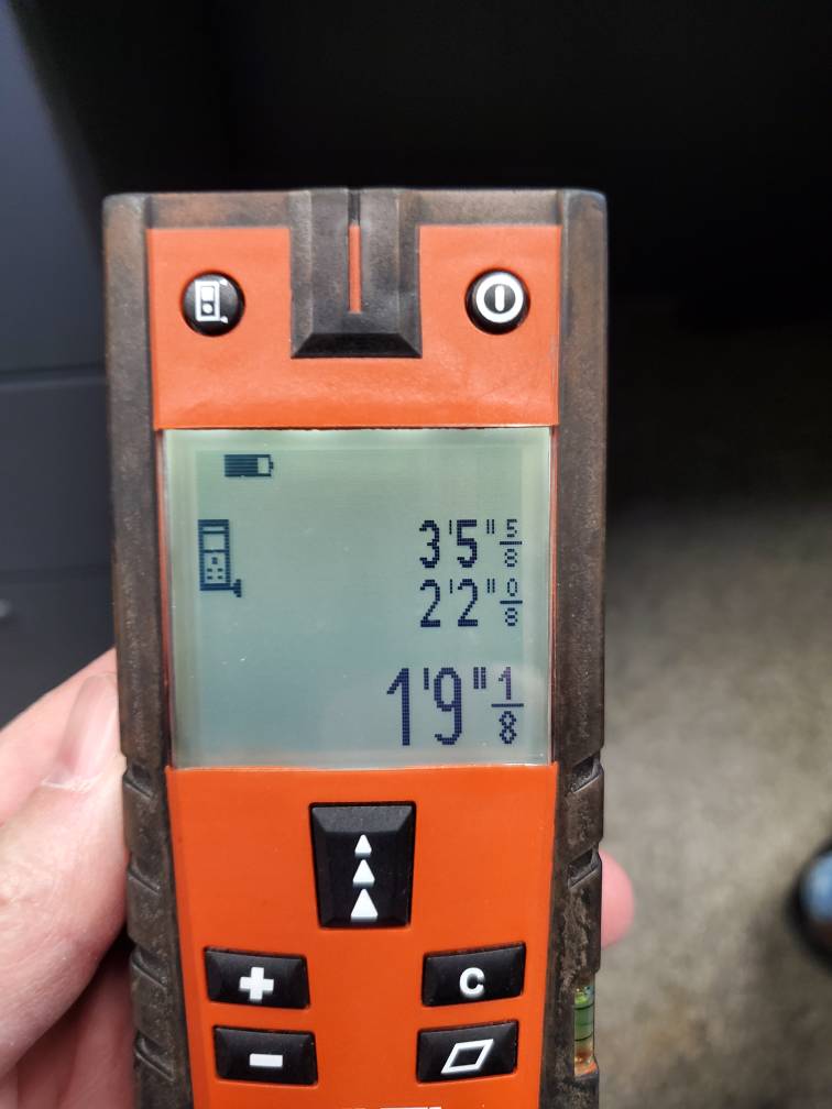

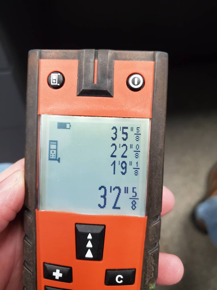

Hilti does not have that either. However it does display the last 4 measurements.
