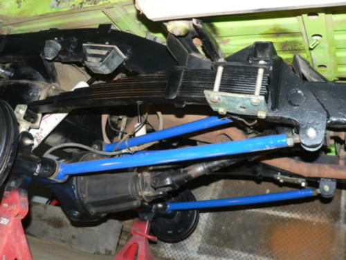

Coils all the way! I really like the 5-link system that comes stock on most jeeps. It rides great, handles good, and flexes and works well offroad.
I wheeled a YJ for years in multiple variations of leaf springs, they all sucked for one reason or another. One was too stiff, one too soft and would sag within months, another one had to much axle wrap, etc.... Coils and links you can adjust everything on the fly and you can say good bye to the jarring ride.
I've been impressed w coils since I rode in late 70s, lifted Ford SFAs way back when. Trucks and Bronco's, I had a 72 Blazer at the time. It was better handleing on the road, but the coils up front ride so much softer offroad than 4 leafsprings to me. I do not bash rocks. It always looked expensive to me to build for or run on them!!!! Leaves are obviously tough and cheaper than coil spring setups though. I've replaced mine, F/R, 2 times on my 84 Toyota for sagging and losing height, broke a rear leaf once, just one in the stack. Heavy loads of firewood gotten offroad took their toll.

I voted coils since I assume we are talking trail rigs. I like the four leaves on my tow rig, since it feels nice and stable, but I prefer coils on my trail rig. Why? It had front coils already (78 f150) but I bent a leaf spring in August 2010 in harlan. It severely rearched a deaver superflex lift spring so the left rear sat 4" higher than the right. Four link and coils this past winter and haven't looked back.
