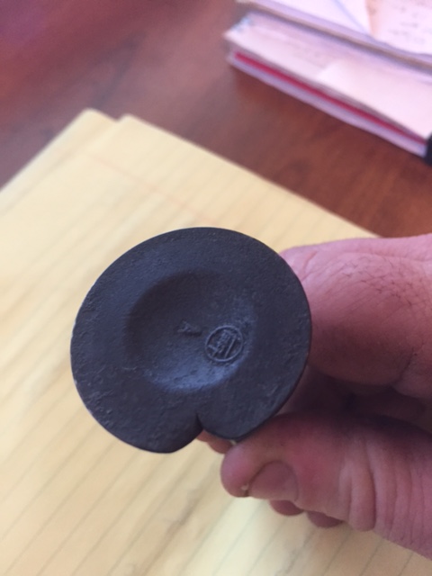

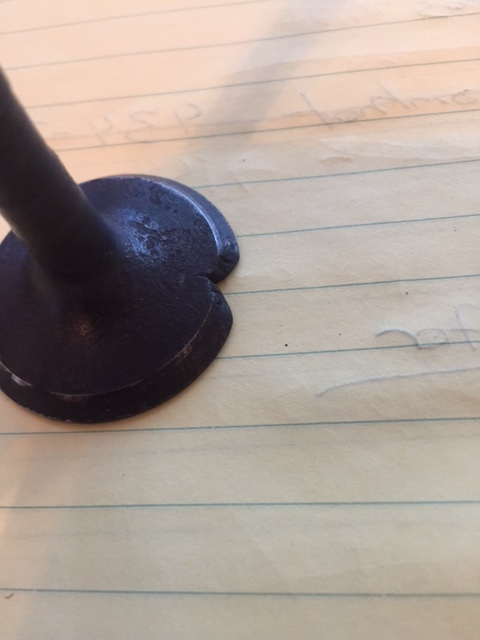

If its sticking because of carbon build up, seafoam will help. If the valve or seat are burnt it will do no good. Driving it with a leaky valve will cause it to burn the valve worse.

don't drive too long or this will happen , I was able to save the seat , guy at the parts counter looked confused when I asked for 1 exhaust valve and 1 head gasket.
