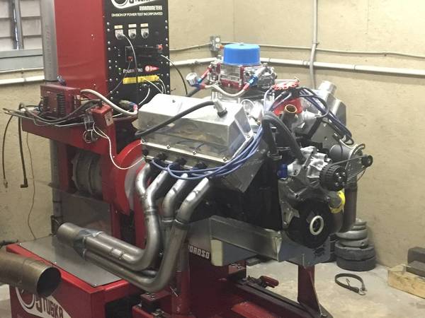

Finally got around to dyno'ing this baaaaaaaaaad boat anchor. The best I can tell, it's the highest known hp/ci pump gas 400 based engine around. Within 17hp of the highest known stroker that has 30 more cubes and a better hp/ci than the engine masters build in 2015.
This is LEBs attempt at building a world class pump gas street build Ford 351m/400 to compete against some of the best names in the business. Our most important concerns were reliability, run well on pump gas 93 octane and enough manners and vacuum for it to be fun to drive. Granted, we left some RPM and horsepower on the table in order to achieve these goals.

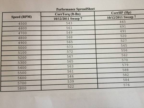

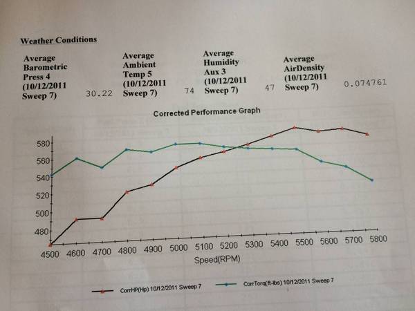

Everyone wants numbers, so here goes
588hp @ 5500rpm 573tq @ 5000rpm
