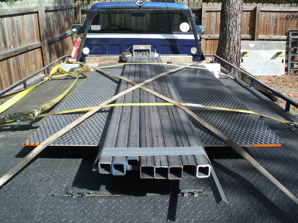

I started with this.

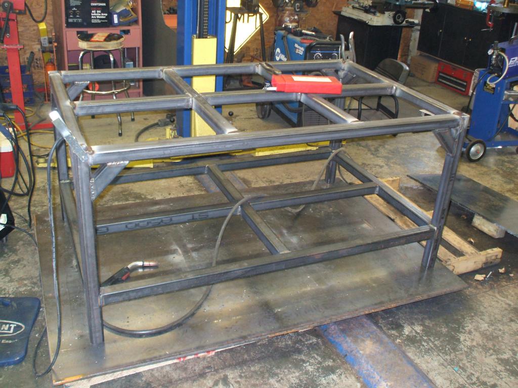

Here is the frame work.

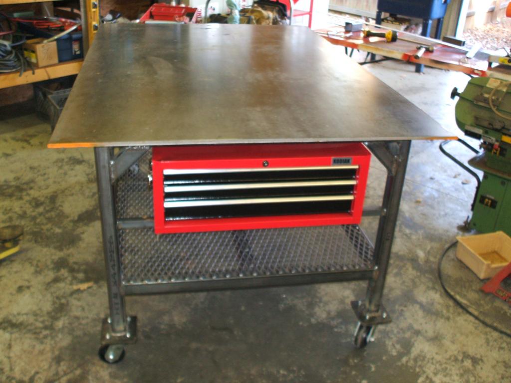

Here is the final product. The top is 4'x6'

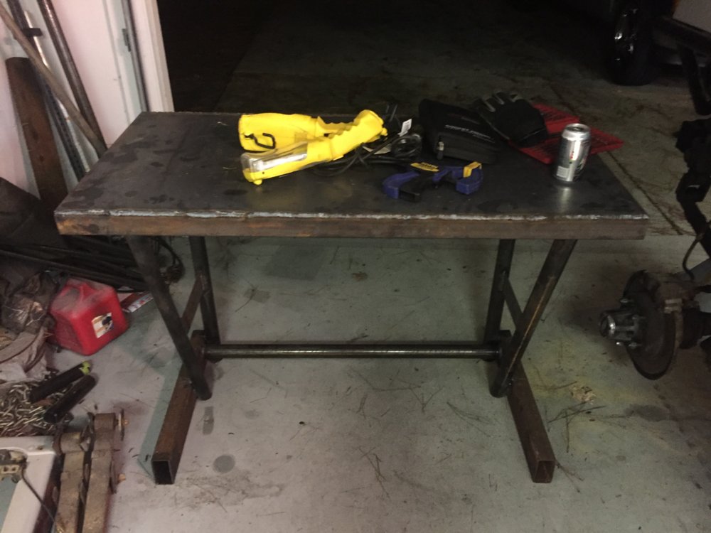

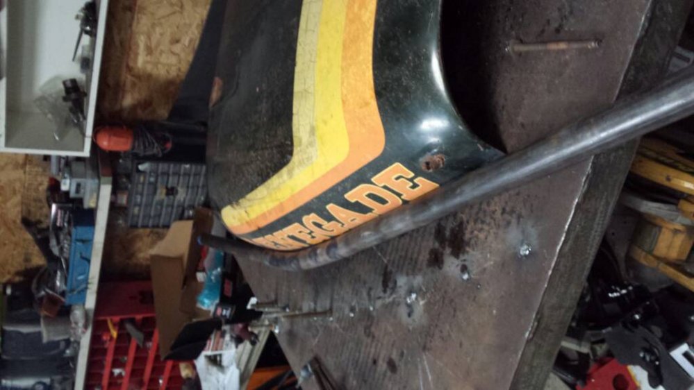

Here's mine. Top is only 3/16 plate but has alot of angle iron bracing underneath and holds up well. All the metal was stuff I bought at scrap prices and I already had the casters so I have less than $100 in it. I tacked some bolts to table to make a jig to get a tight bend to match my hood for cj. Once done knocked them off and grinder back smooth and you would never know they were there.

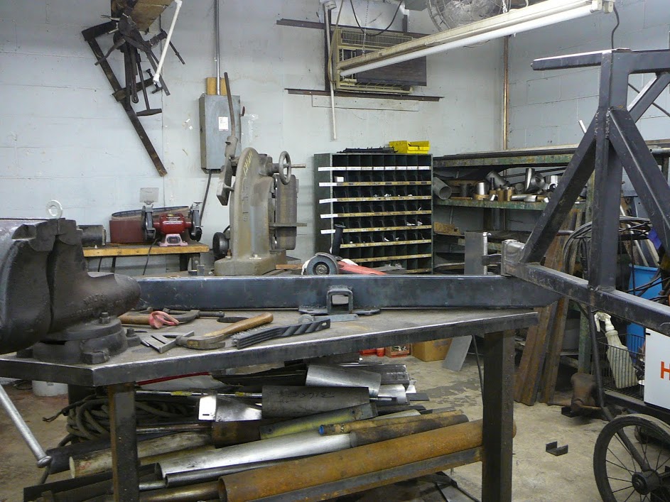

All of my tables have tons of random clutter. So...

The pic above is one of the rare occasions table is clean. I usually end up welding on the floor 8 out of 10 times also.

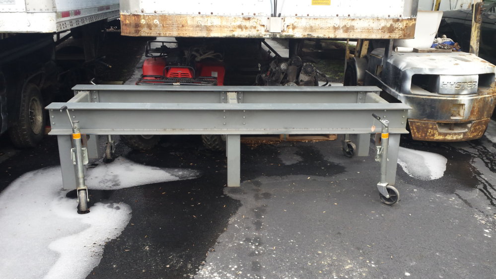

Not my welding table, but was designed real well. Its a jig table I bought from a guy I plan to use to build chassis on. Can use the same principle. Has 4 trailer jacks at the corners that go into receivers so they are removable and 6 legs with adjustable feet to level the table out.
