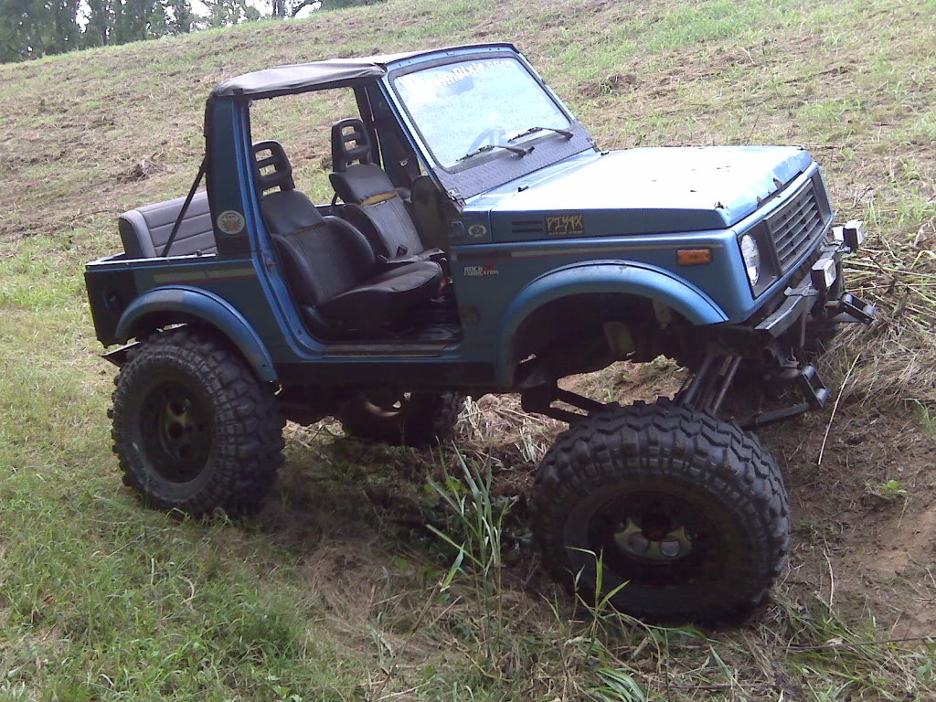

Here's my pile.
Specs:
1987 Sami
1.6 16v
p/s w/ GM Saginaw pump and Track-Kick box
hydro assist w/ cooler
3 spd a/t w/ remote filter and cooler
twin sticked stock t-case with Shogun doubler and Mighty Kong
revolver shackles & YJ lift springs at all 4 corners
4.88's (welded front and rear), Yota axles
Ford front shock towers (got to put them back on)
36" SX's and H1 beadlocks
Spidertrax panhard bar
Sky hi steer
16" e-fan pulling 2800 cfm!
Thanks are they stock shafts?
Yup. I've beat on them pretty hard the 4 times I really went on a trail ride and they are holding up great.

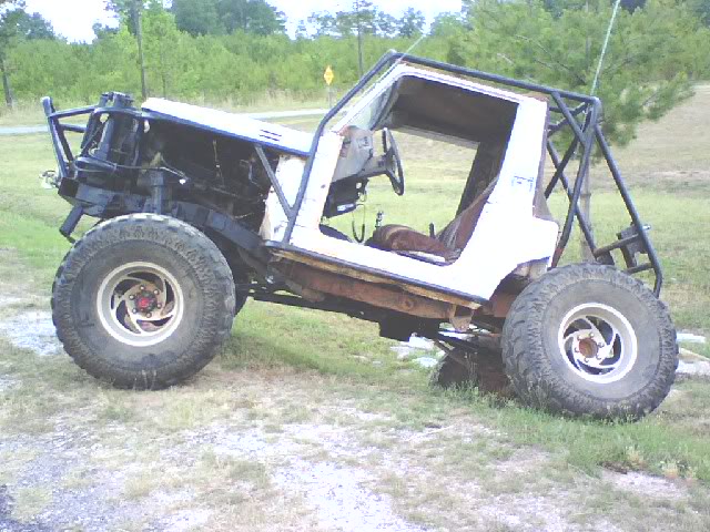

My 12 year old sons, 1.3 engine with 6.5 T/C gears, 4.10 axle gears welded front and rear with coils in the front and leafs in the rear on 35 SSR's and a 94 inch wheel base.

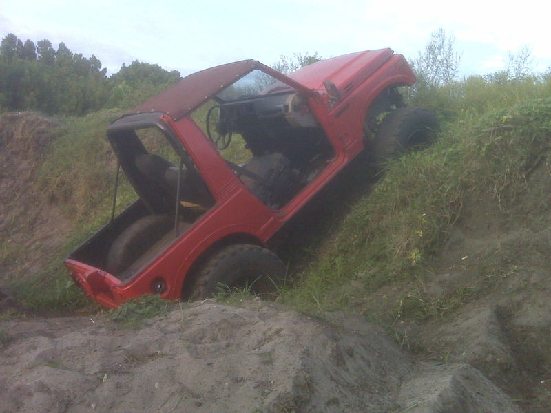

My mud toy, 33LTB's on sammi front and tracker hybrid rear axles with 5,12 gears seded front and rear with 5.14 T/C gears with a slightly built 1.3
My rock toy. Stretched 16 inch frame, yota axles with 4.30 gears with 3/4 elipticle rear an M/L front wekded front and rear on 35's. Oh yeah and with a 5.0 V-8 and auto tranny and 5.14 T/C gears
