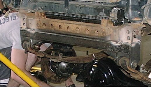

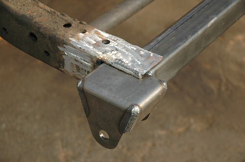

It actually does lift it, you weld this under the factory spring hanger support therefore it raises it up, I think in only and inch -1.5" but the lift it gives is what allows you to run rears up front without having pinion angle issues, the small amount of lift the drop hanger gives almost puts it back to factory, if you completely cut out the front hanger support and welded this one back into place maybe it wouldn't give any lift but mine did
If you installed it like this there would be no lift added
Installing it under the factory hanger support does add some lift
It didn't lift mine. When you cut the factory spring hangers off the front, then weld in the new hanger. On mine, the part where your leaf spring bolts to it, it hung down the same distance as the stock mounts. IT DID NOT LIFT MY TRUCK ANY!!!!!! It has to be the low profile hanger.
This weekend I measured a stock 85 spring hanger from the radiator support is 2"1/4 I then measured my trailgear hanger and it is 3.5" therefore I got 1"1/4 lift from the hanger
Measured my brothers 81 same frame same spring hanger same measurements. I ain't arguing either just stating how mine turned out !
