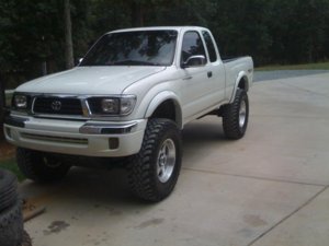

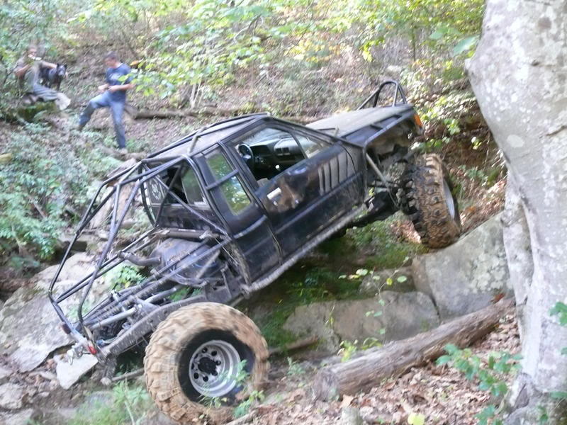

heres my yota new front exo and 22r3 w56 tranny 2 top shift tcases rear case has 4.7 rear disco for front digs and 5.29 in the axles and 38-11.00-15 boggers with weld on bead locks and 8000lbs smitty built wintch

1996 white tacoma on 35s
2001 green tacoma on 33s

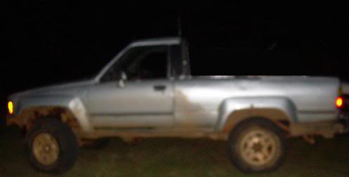

^^^^ ever seen anyone mess there britches over your 40? cuz i just did. probably the baddest one ive ever seen in life
thanks man yeah i sold it and ive been trying to buy it back the guy that bought is an idiot!!!!!
awww man that sucks. hope youg geter back. i sold my yota last year and bough tit back lol
new pic new stuff. duals 4.7, ifs rear, ruf (springs made by been jammin) 30s up front, 5.29s, welded rear, 37's, and bud built banana shackles. Soon to upgrade the brake system and have been put on an exo cage.

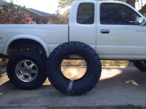

Just picked up this Toyotascraper Thursday:
Got some stuff to clean up/minor repair, and lower it a lot! 3" body lift will be gone STAT!
Cant wait to go wheelin open/open and 33's!

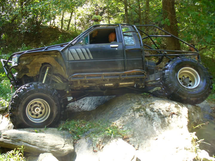

Front axle
'78 Dodge D60 narrowed 3.5"(64" WMS-WMS)
5.86 gears
Detroit No-Spin
35spline 4340 inners/D70 35spline outers
Rear axle
Narrowed D60HD(63" WMS-WMS)
5.86's
Spool
35spline Dutchman axles
Disc brakes
Drivetrain
Dave'z Offroad 22re with upgraded cam and LC Engineering header
New ceramic clutch
Dual t-cases with 23spline 4.7's and twin sticks in the rear case
Budbuilt crossmember with 2" drivetrain lift
Tires and wheels
40" LTB's on 16x12" Stazworks double bead locks
Suspension
Sky SFA kit with boomerang shackle
3" TG front springs
Front axle relocated 3" forward
57" 2wd F150 springs
Slip and twist anti-wrap bar
