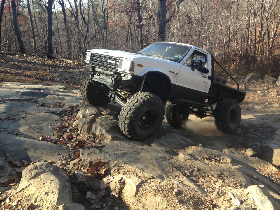

Just picked it up couple weeks ago
3.0 V6 automatic
Dodge Dana 60 Front axle with 5.13 gears and a 35 spline Detroit. Stock shafts
High angle driveline Dana 60 to Toyota pinion flange.
Ford Dana 60 rear axle loaded with 5.13 gears and 30 spline spool with stock shafts rear disk conversion brackets included not installed
Trail Gear rear Leaf spring swap with 5.5 inch springs
All pro offroad SAS 5 inch springs and shock hoops (need installed)
Sky manufacturing pitman arm
Sky manufacturing brake booster adapter with GM 3/4 ton master.
Stock Tank and pump installed to a switch.
255 LPG external fuel pump included
Five 37x12.5x 16.5 Humvee tires
Five 16.5x8.25 procomp rock crawler wheels
Ballistic Fabrication High steer arms
Ballistic Fab dana 60 diff covers
Ballistic Fab high steer crossover kit. With one ton Chevy tie rod ends
Steering box has been relocated to clear the steering.
Custom Square Tube drive shafts front and rear Cv in the rear. (Front shaft sits at 27 degrees but does not bind yokes have been clearanced and has 106 degrees of movement before bind 53 degrees every direction.

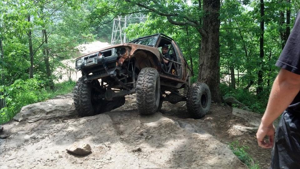

Don't really have a lot of wheeling pics
ai895.photobucket.com_albums_ac151_kouperstein2_Harlan_20June_202013_IMG_3237_zps621ed3b1.jpg
ai895.photobucket.com_albums_ac151_kouperstein2_Scrubgrass_20OHV_207_8_12_abea3bb7.jpg
ai895.photobucket.com_albums_ac151_kouperstein2_Scrubgrass_20OHV_207_8_12_eb5ffe6f.jpg

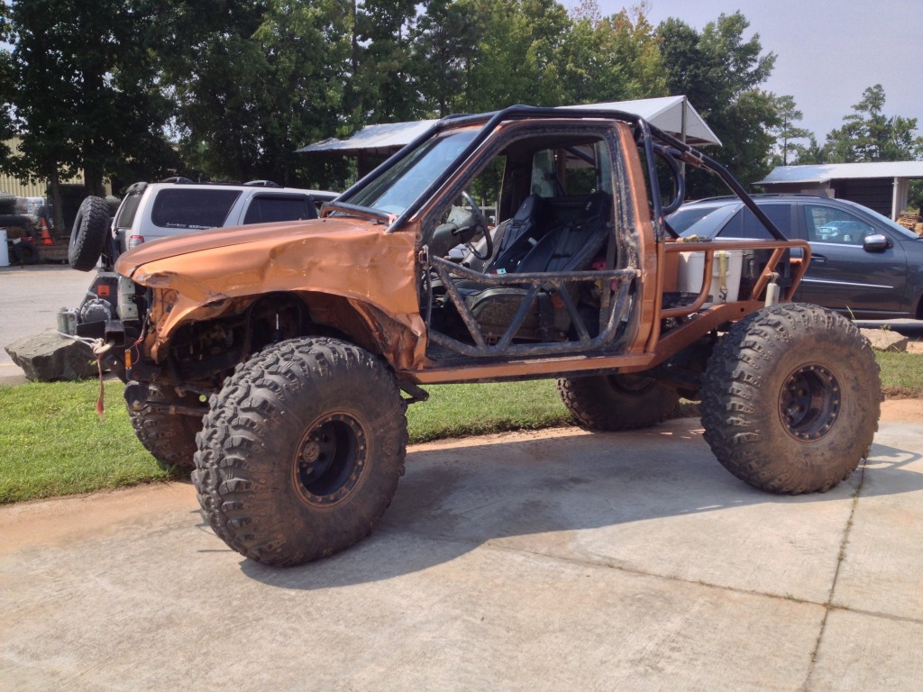

Looking back through my pics, this was day 1 of assembly. The 8 months that followed had very limited amounts of sleep.
ai895.photobucket.com_albums_ac151_kouperstein2_truggy_20build_IMG_20111023_165814.jpg

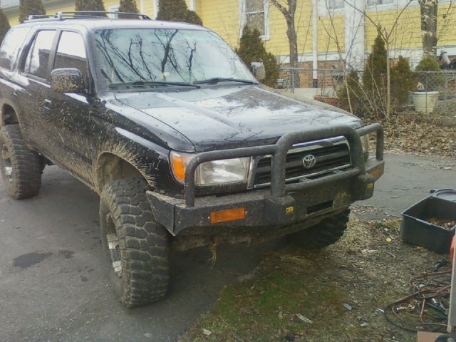

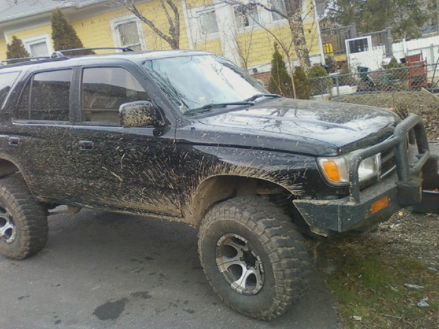

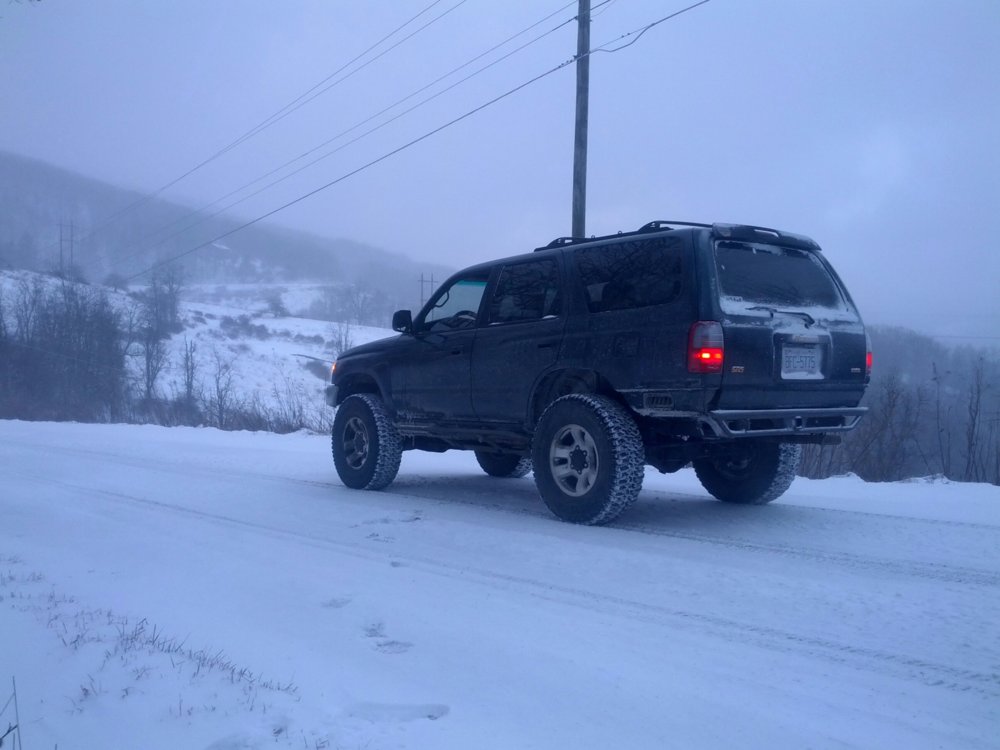

My new to me 1996 Toyota 4runner 3 inch Lift 32/11.50/15 BFG KM2 TJM bumper factory Elocker
