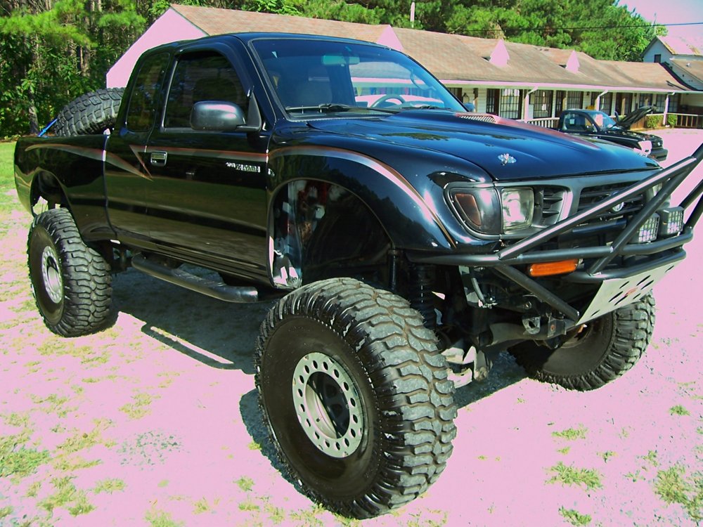

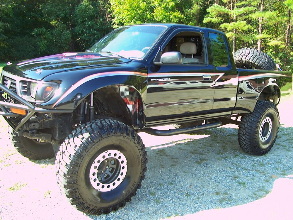

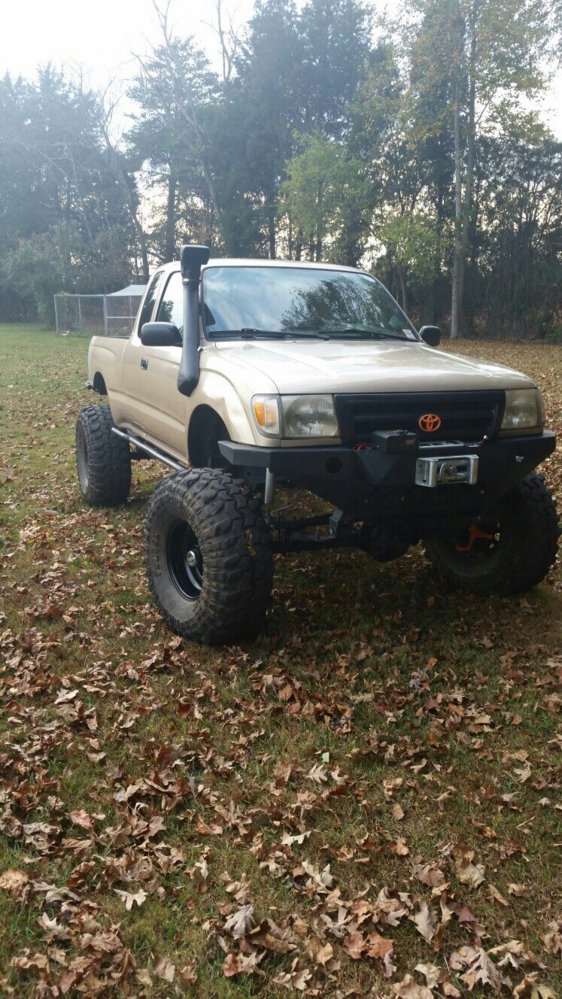

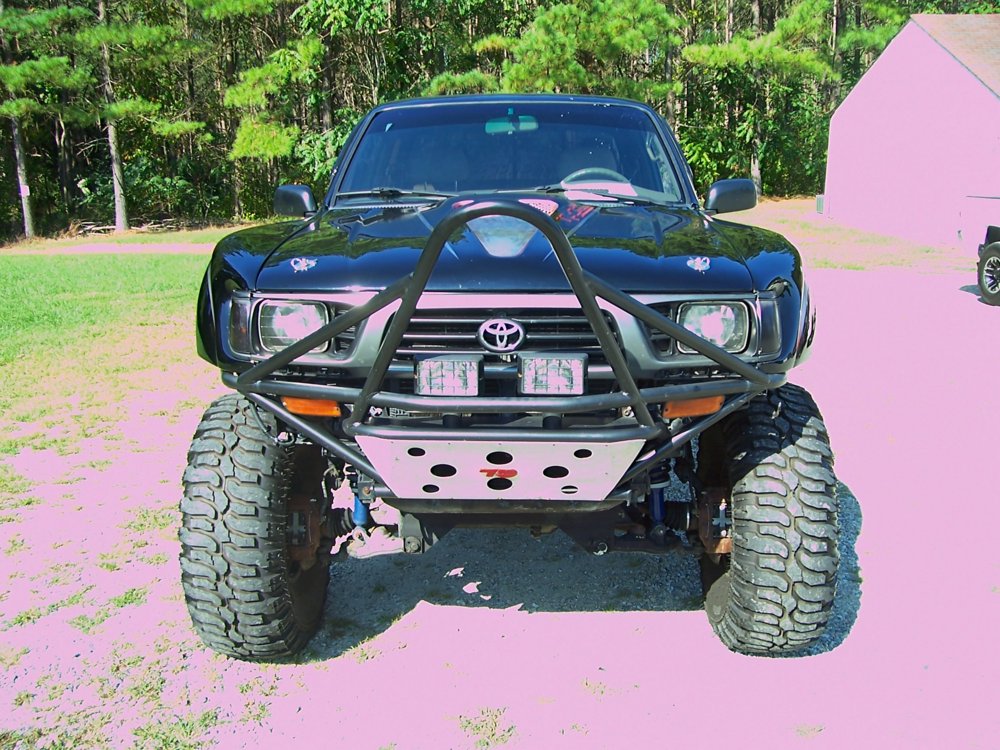

Lets see your yota?

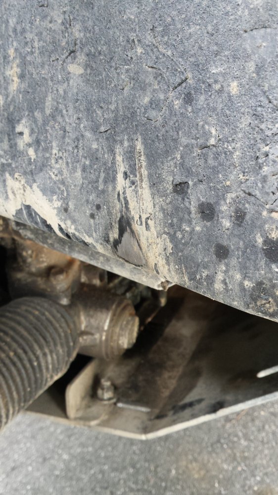

I have already cut the pinch weld and hammered on the firewall, so I should be good there. Any rubbing on the frame when turned full lock?
Mine rub the front subframe and the frame just enough to wear the paint off. I don't even notice it wheeling.
Thats not bad at all. I can live with that. I think.
