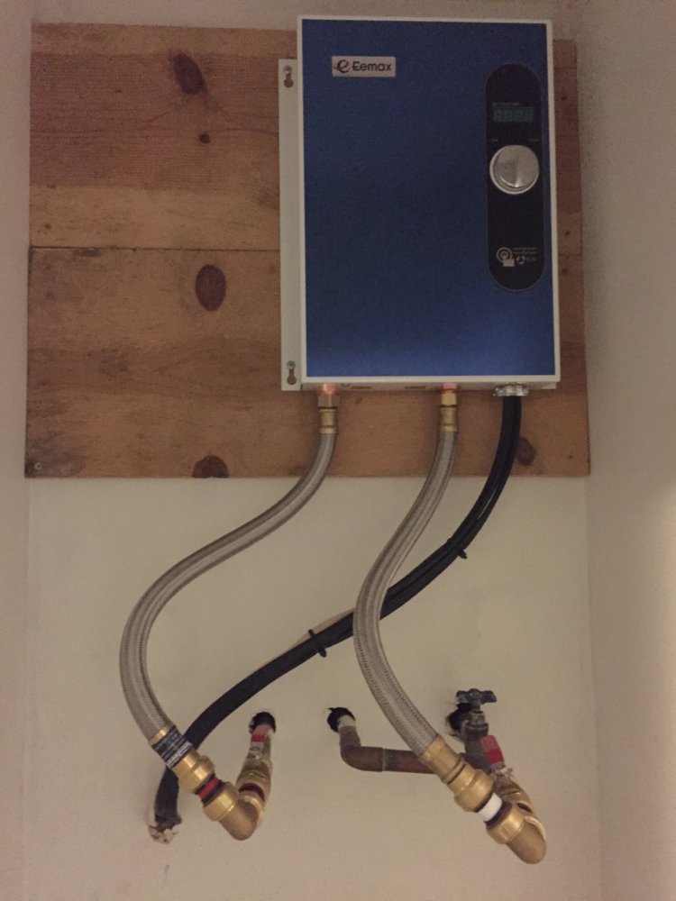

You can get into electricity bill analysis paralysis, but the electric tankless units are feasible to run in the southeast, both in regards to energy cost and incoming groundwater temperature. It's a matter of preference if the home or building's incoming service can accommodate the ampacity required for tankless water heating. A minimum of 100A electrical utility service size needed for these units.
The attached pic is how my unit turned out. The smaller tankless units don't require T&P valves also, which is pretty neat. Saves a ton of space in the closet and makes for a simple 1-man install or replacement.
I'm sure I'll get some electric and plumbing code nazis out for not installing blah blah blah, but whatever. It very well works for my application and, unlike a storage-based WH, it never runs out of hot water.
