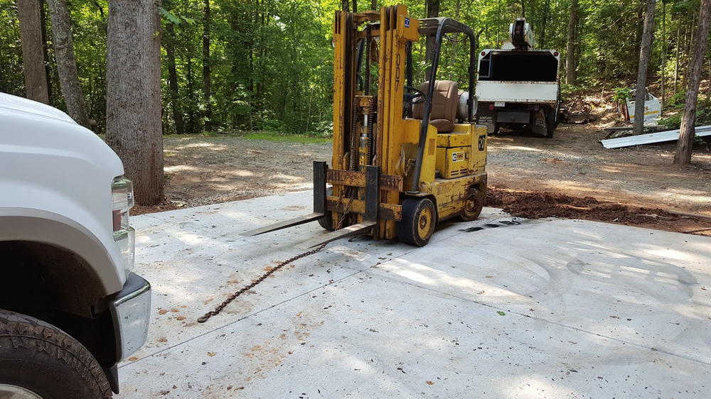

The seal on the lift cylinder on my 40+ year old Cat T50C finally gave out, so its time to replace it. I got a quote for about $1500 to get it rebuilt (full service, they come and pick it up, fix it, drop it back off). It's been a solid machine, and required very little in the 15+ years I've owned it. Everything about it is a little rough around the edges, but I know what I have and what to expect. With that said, I've also been wanting to buy longer forks and better tires for it, the propane always seems to run out at the worst time, and I'd really like to add side shift, so instead of dumping $1500 into a machine that is probably only worth $2-3k and I want to do $4k worth of upgrades to, I'm wondering if I'd be better off making the jump and upgrading to something newer (and electric maybe). But my only experience has been with this old worn out Cat T50C, so I don't even know where to start. Whats the good/bad/ugly, brands to stay away from, things to look for, etc? Budget would ideally be about $5-7k.

Agreed, the price seems fair. They said $350 for seal kit, $500 labor if I bring them the cylinder, $825 labor if I bring them the machine, and I figured another $300ish to have them come pick it up. The $825 price seems like a no brainer, only $325 more for them to pull the cylinder, deal with the spilled fluid, put it back in, and seal/fill it back up seems well worth the difference. Problem is, by the time they do all that, and replace the 4 hoses going to the mast/cylinder, and a few sliders, and who knows what else, it will end up being $2k all in.
That's what led me to do a bit more math:
$1500 I could get for my machine as is with leaking cylinder
$2000 spent on fixing cylinder
$1000 on 5ft forks
$1000 for wheels/tires with tread instead of completely smooth (no idea on the number here, just throwing something out)
$5500 in total value I could extract/avoid by getting something else
So basically if I spend $5-6k and it works and has longer forks and better tires, it's a breakeven in my book.

As for the tires, you’ve probably learned already that getting into gravel with your machine is not a good thing, and honestly, adding treaded tires will only make that worse, it will just dig faster. And tread won’t help much on wet pavement either
you have a “cushion tire” machine, it is designed for hard surfaces, period. The foot print of the tire is more concentrated on a smaller area. Unfortunately you cannot convert to pneumatic tires and gain much of anything, due to size constraint (and cost, you’d have to change wheels if they’re even available)

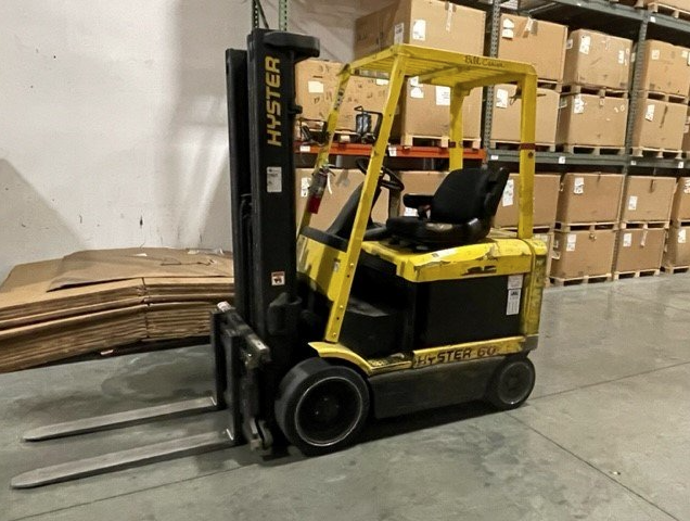

I'd like to go ahead and say that I'm impulsive and I don't listen...
and I bought this today
Went and ran it at lunchtime and its nice, tight, and overall in great shape. I figure it will need batteries in the next couple years, but they are fine for now. It was at the very bottom of my budget, and came with a single phase charger. Its actually more compact than my current one, has a 6k capacity instead of 5k, larger tires, a 3 stage mast, and side shift. And a horn and lights that work! (My kids will love that, haha!) Hopefully its as solid and troublefree as my Cat has been.

Nice. I hope it stays on concrete for the most part.
Water the battery, how often is something you need to watch. THAT can greatly effect battery life, use distilled if at all possible, avoid using well water especially if it has any iron content
Thanks for the advice. I learned that the hard way maintaining the double 48v bank on my SXS. Our well water is slap full of iron, and even post filtering, it fouled a couple batteries. Fortunately they were already on their last leg and I was just buying some time. This one has a watering system installed, so that should make it a lot easier.
