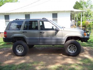

Tire width will play a factor as well as height in terms of clearance. When I ran 33x10.5" BFG AT's it never rubbed. When I changed over to 33x12.5" Maxxis Bighorns it rubbed pretty bad on the pinch seam in the wheel well. It took some trimming to drive on the street but I had to flatten it against he wheel well to wheel it. I am running a 4.5" RE on my ZJ.

If I was you Id get long arms, or it will look like the above post, it will center everything out for you, and flex like crazy. stock control arms arent long enough for that much lift especially if you want to go offroad alot. and as far as the brake lines you wont need any for a wj, you'll be fine, they are on the axle. and tire size, yeah you can fit 33s but if you have quadradrive with the vari-lock, anything over 32" is supposed to tear them up pretty fast. Im thinking of doing the same height lift but prob IRO or Clayton. Good luck post pics when you're done!!

Believe it or not, it does not rub after I took care of the pinch seam in the front wheel well. As the suspension compresses the tires center themselves in the wheel well. It is close but it works fine off road as well as on. I am not familiar with the WJ setup but I will second the use of Clayton kits they have great stuff. Long arms will ride MUCH better on road and flex better off road. You can see the rear lower control arm in he pic, at that angle I have very little down travel compared to a long arm kit. Also, consider how the front control arms are angled on my Jeep, when I hit a bump on the road it is harder for the suspension to absorb the force due to the control arms being much closer to vertical opposed to the stock configuration. A long arm kit will mostly eliminate this issue.

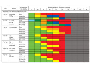

This should help you a bit.

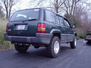

spraypaintman, what paint did you use for the cladding, and how is it holding up? <sorry to hijack your thread>
I used the Krylon plastic paint on mine. Sorry no pics but it looks just like spraypaintman's. It is holding up pretty well, I painted them in the spring. I had some issues with one panel but I think I just didn't prepare it properly.
Just used regular gloss spraypaint from the dollar store. Clean everything down with windex and it will stick for years. :beer: I had a ZJ a while back I did this to and it held up good.
