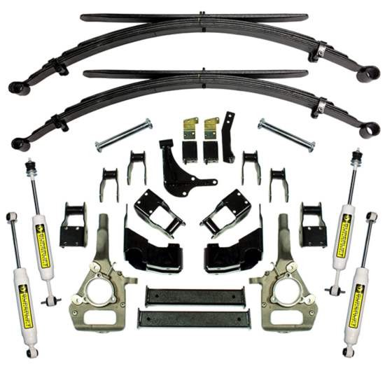

Hell if you end up with a Cherokee and it doesn't have a lift I think my old lift is still sitting in my buddies shop. If so you can have it. I think it's 4" you'd need some shackles for the rear and shocks and good to go.
awww.rockymountainsusp.com_media_catalog_product_cache_1_image93b85ddce14e89636f5dfe8440d9280b.jpg
IFS front, rear leaf sprung. I would be different, but yes more cost to "build". I use that term lightly since that could head numerous ways.
Isnt the '02 4 door IRS? Maybe sports and sport trac stayed solid axle for a while lobger. I don't know, it's been a long time since I kept up with explorer stuff.
I believe you are correct. I did a quick search to find lifts and that popped up. Looks like it was only the little pickup version that carries a straight axle that long. If that's the case I completely agree with Shawn. Look elsewhere. Maybe the OP should look under his rig.
