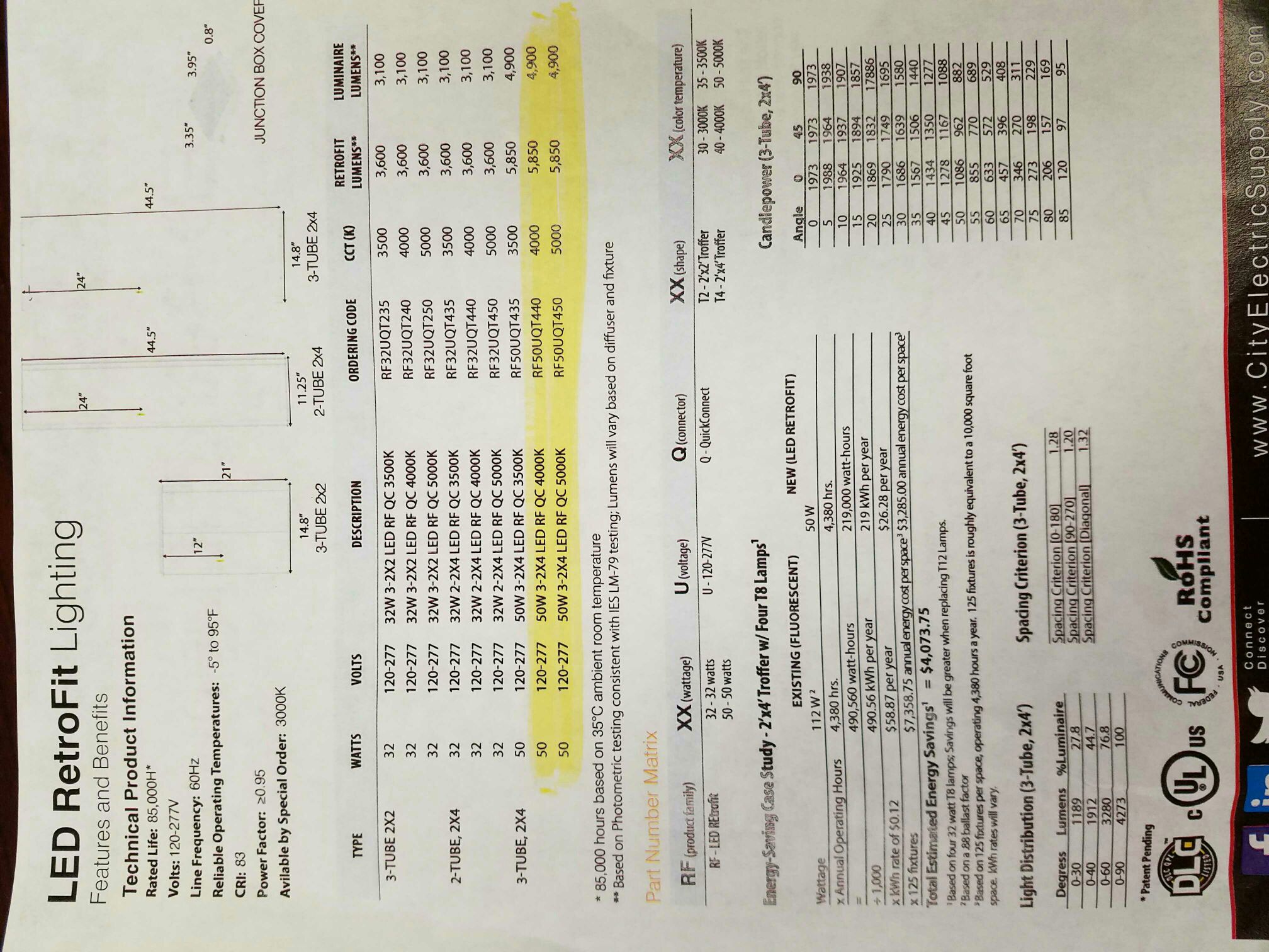

If you go led duke had some good rebates that make it worth it I'm doing a big retrofit with light Tronics stuff there 84 bucks each after the rebate I payed 25 per kit
Got a link for more info?
