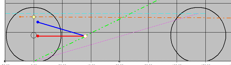

Since this calc doesn't do leafs, Ill improvise...
This shows a front leaf eye level with the axle centerline. (arbitrarily using 36" lever arm length)
This results in 168% static anti squat. Under acceleration, without the traction bar, the percentage would actually rise as the leaf wraps up because the instant center rises. But the traction bar will resist the rise in the instant point, thus preventing the dynamic anti squat from rising. Or effectively lowering the resultant dynamic anti squat. Note...Nothing I do here can produce "pro squat".

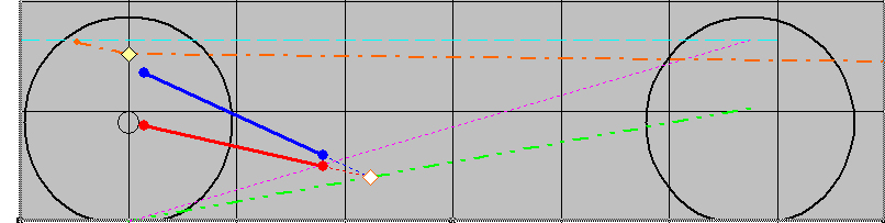

This is what you would have to do to achieve pro squat in a leaf setup...this results in 62% (think, any point below the anti squat line (violet) will be less than 100%)
Or I could make the front lever arm very long!
