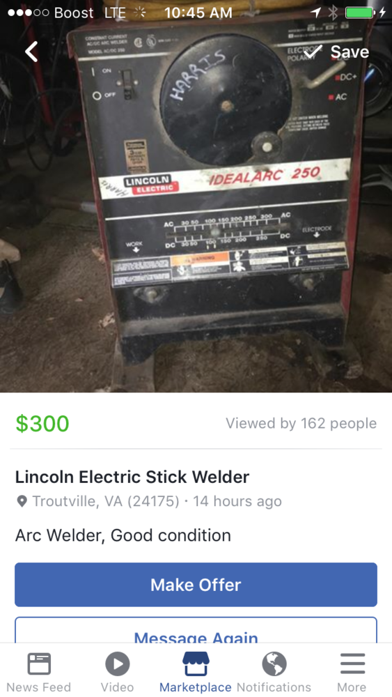

Lincoln idealarc ac/dc 250 worth buying??
C.Berry
Bad News
Aug 10, 2008
Blacksburg, Va
found one for $300 I see they sale for 2400$ what's the catch? Should I jump on this? It's 375lbs
I hear they are dirt cheap to rebuild but this one seems well taken care of from what I can tell.
Old man said it welds like normal no tank or tig setup tho
If it's constant current it's single phase correct? I can essentially buy a nice generator to run this as mobile unit couldn't I?
Constant current is for tig and stick
Constant voltage is for mig
If you see a machine that says cc/cv then it's set up for both.
Figure another $250- $300 for an Argon tank and $100- $300 for a torch setup plus leads, stinger, ground cable, etc
Obviously I have a lot to learn! Lol I'm enrolling in classes this fall to start into the welding world, I personally love doing it it's sorta fun/gratifying so why not learn it fully to be better at it? I've never had training just taught the heavier the hotter and thrown a 7018 rod and a tractor rim to weld to another rim haha bet I burnt 100 rods that next few weeks just trying diff stuff been hooked since!
