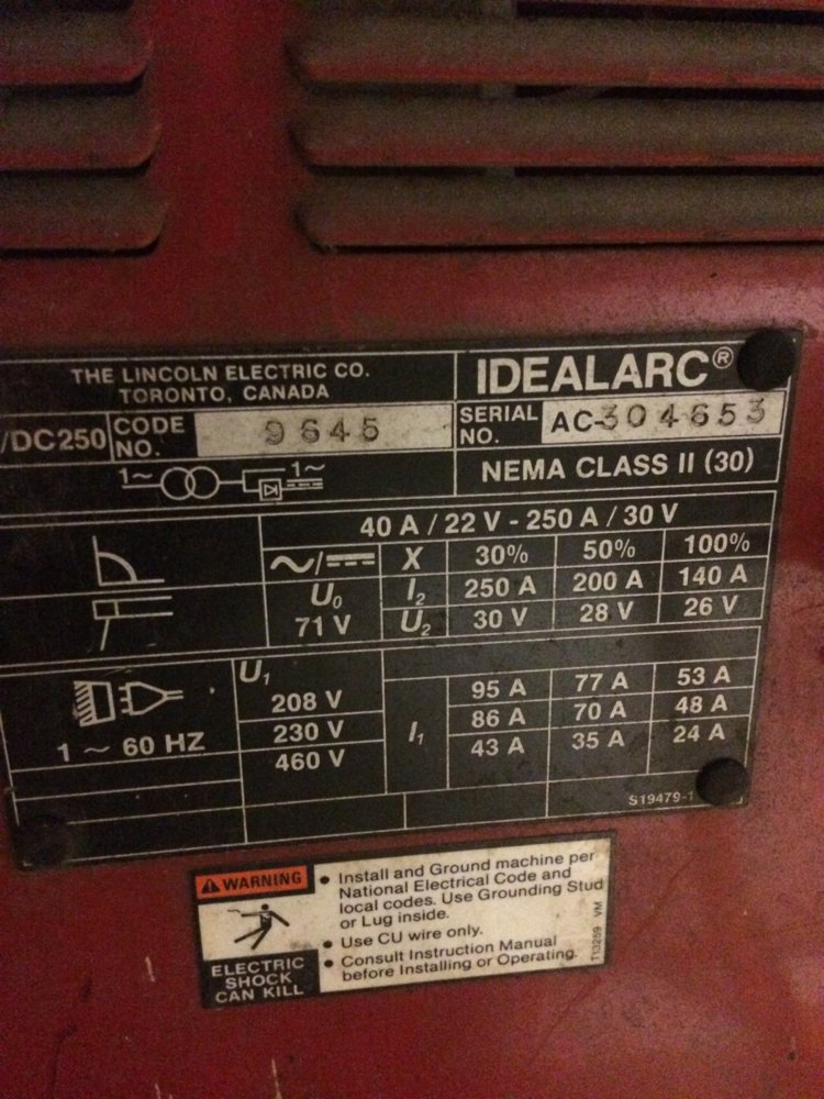

so I may have jumped the gun!? It happens but either way I stole this welder in my opinion working or not... Can't really disagree when some 1940 models still put in 12 hour days! So I picked up a Lincoln idealarc ac/dc 250 for $250 didn't have leads or way to test it... bad decision? I guess we'll see,had people in driveway to buy it tho so I jumped, I know these machines are long lasting and have good arc and adjustability but what options does this machine really havecan strike tig be nice enough quality to go that route with it or am I just gonna be stupid happy to have a badass stick welder?? Any input is welcome I've been researching and most info is on the tombstone models this one is roughly 1980ish maybe 90s I won't know till tom!

So I just popped it open and it doesn't have the factor capacitor in it, does it need it really or should I just be happy I got this heavy ass thing? And does anyone know how to tell the year from serial number the Lincoln site shows diff codes and numbers than mine...?
I didn't see ac304652 on that list it's Canadian version so it seems! I had a service bulletin up on Lincoln site for the 9645 code but it didn't have all that list did.
