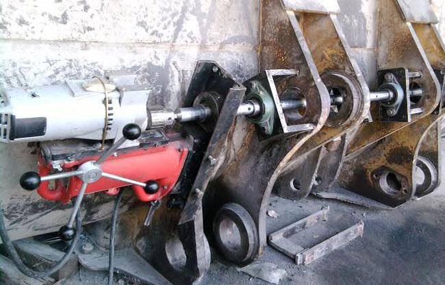

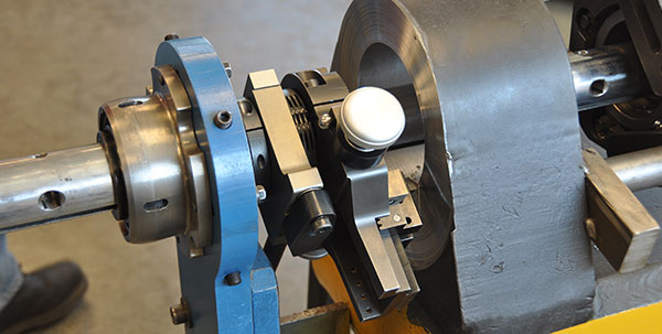

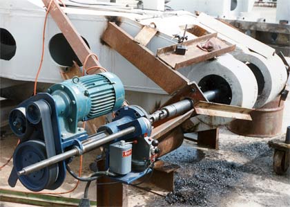

Also done in power plants and generally anything huge and to cumbersome to move. Can be extremely exacting tolerances per specific applications.

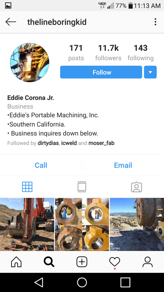

@C.Berry. if you like that sort of stuff and gawk at it like I do check this guy out on Instagram.
icweld on their pointed him out to me...I was asking about equipment to him....iceweld finds himself all sorts of Fubared equipment repairs.
Cali, and Texas respectively.

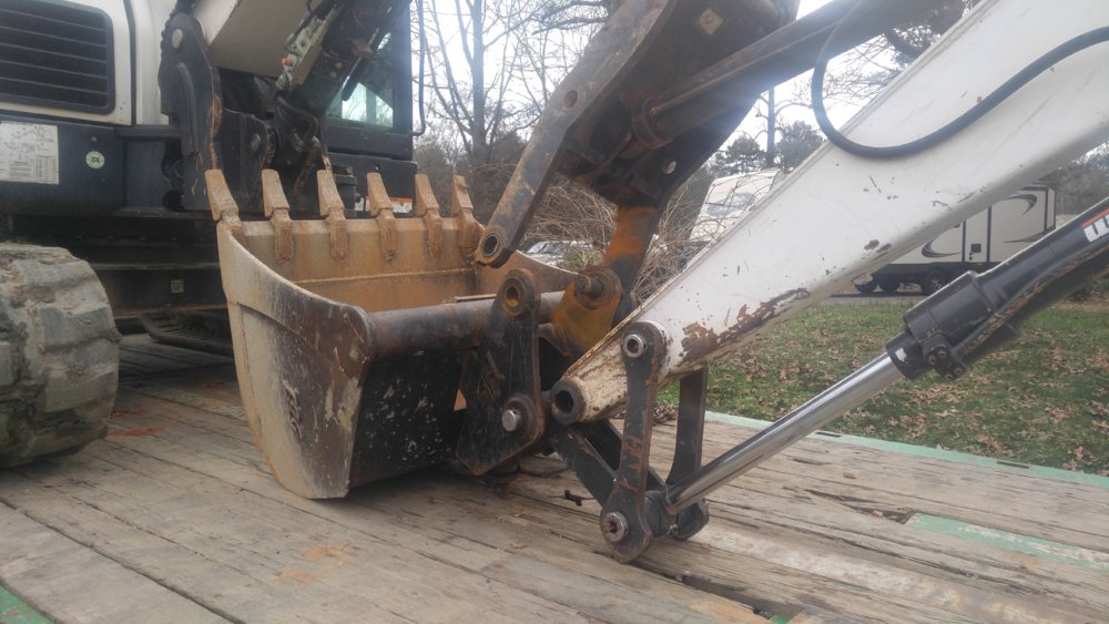

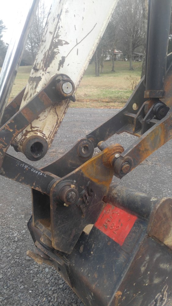

Setup, bore, make a sleeve, weld it, grind it smooth, bore it again, and put in the original size bushing. When I fixed my mini-ex's main eye, it was cheaper to just cut it off and start over with a piece of 4" DOM, some lathe work, and some welding. On that great big stuff, you really only have one option.
I'd love to do line boring. It keeps things interesting. Plus, when nobody else really knows what you're doing, they usually leave you alone while you're doing it....like it's some kind of black magic or something :D
Funny you say this...I got a small fleet of Bobcats to do. This was my first thought. A lathe might be cheaper to purchase. I am striving to keep it all "in house".
Yep...they torched that main eye right on off and made a new one. I think it cost me 450 bucks. Time/money wise, it was a much easier way to do it. Mine was supposed to measure a few thousandths under 2.250 to get good press on the bushings. I measured 2.375 vertically and 2.350 forward to aft. It was wallowed out pretty bad...but not quite as bad as that one!
