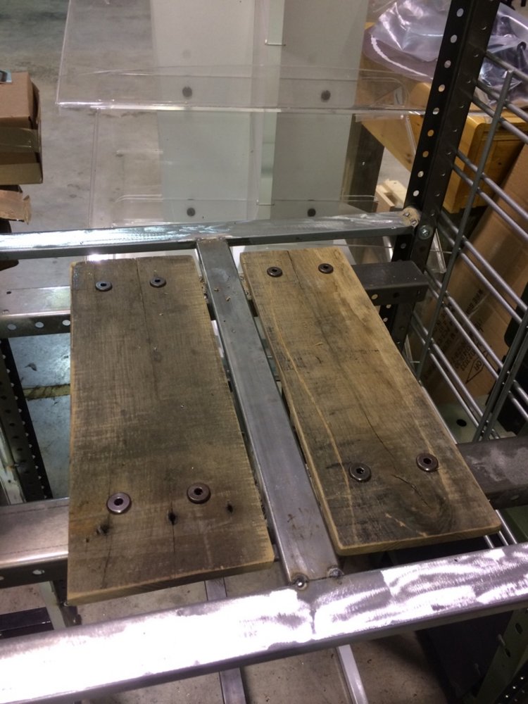

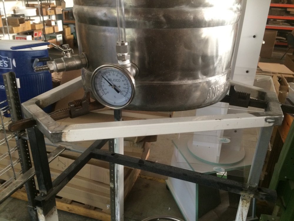

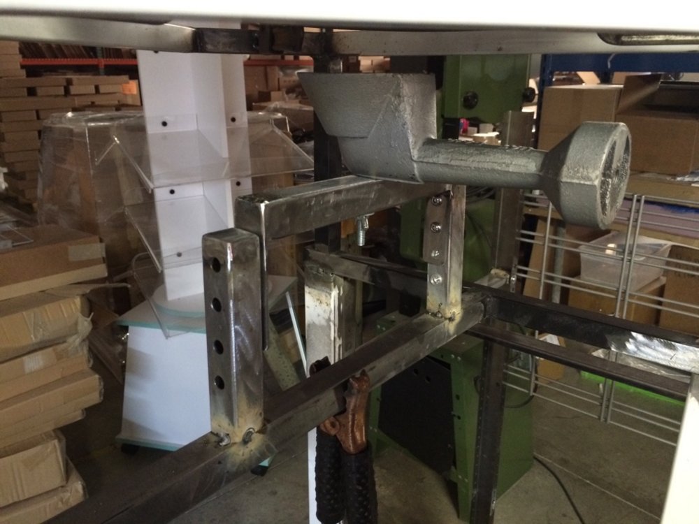

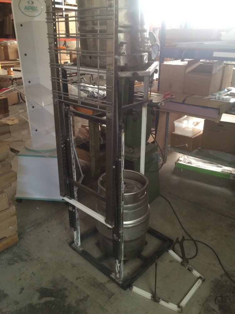

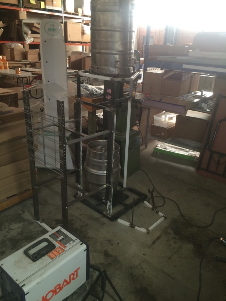

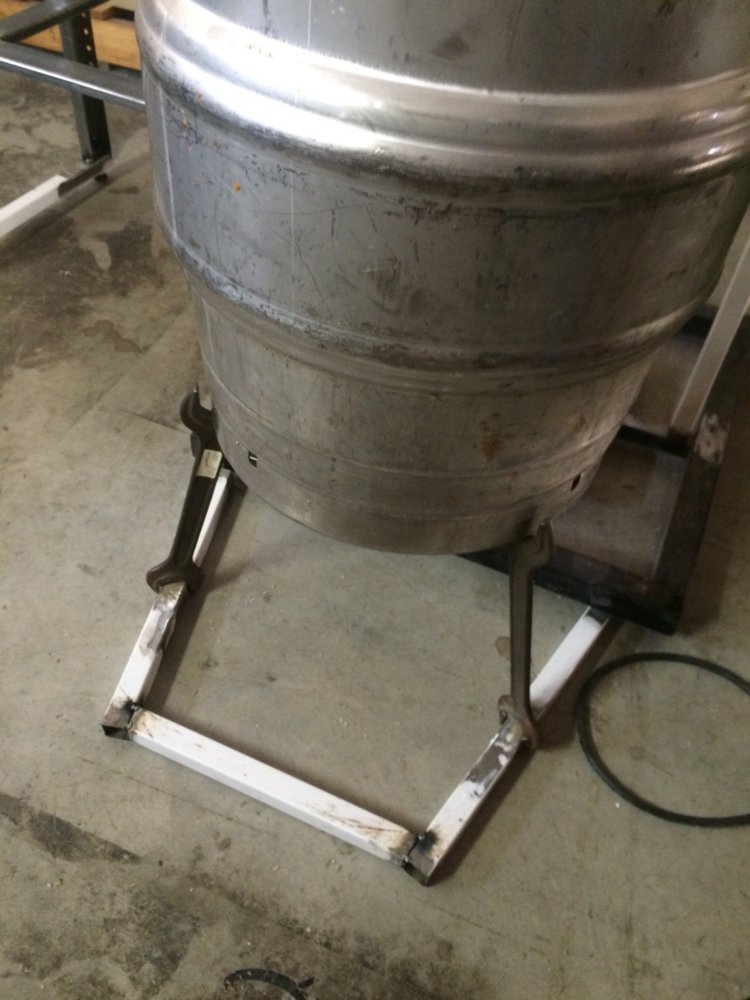

Working on a brew stand for cooking my beer. I work at a company that designs and builds retail displays, so we have tons of left over metal and fasteners and connections. So I'm building it all out of old retail displays and prototypes. Only thing I have bought need to buy are 3 antique adjustable pipe wrenches to hold my upper hot water tank. 3 antique open end wrenches for the lower boil kettle cradle. 2 propane burners, propane regulator and hoses. All in about $80.
