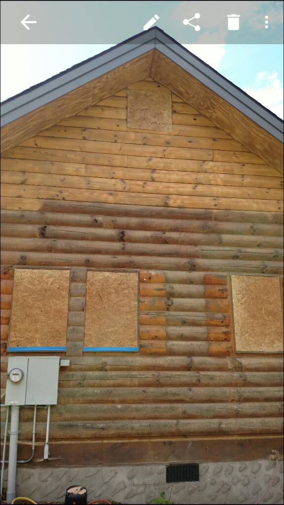

Dry ice, corn media and of course sand. They all will remove the finish and we've used them all. Take a new log to the job and you can see a massive difference in color and stain doesn't seem to take as well after you blast all the old off
top half has been blasted bottom half was what the stain looked like.

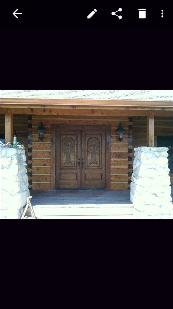

main entrance done
