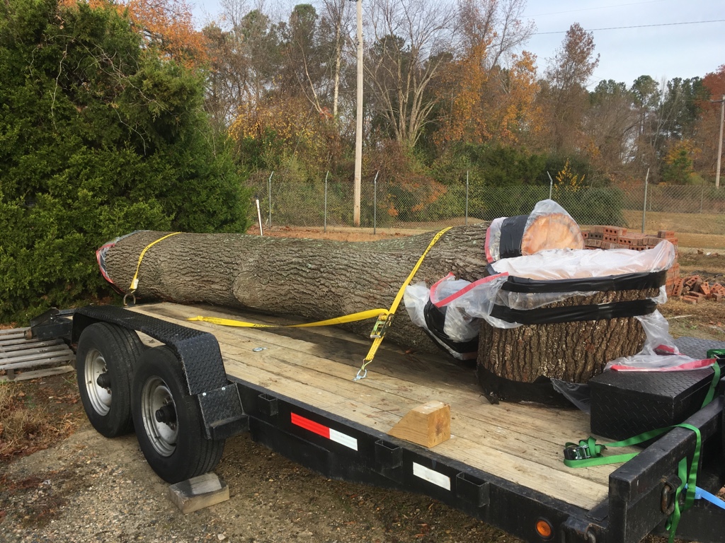

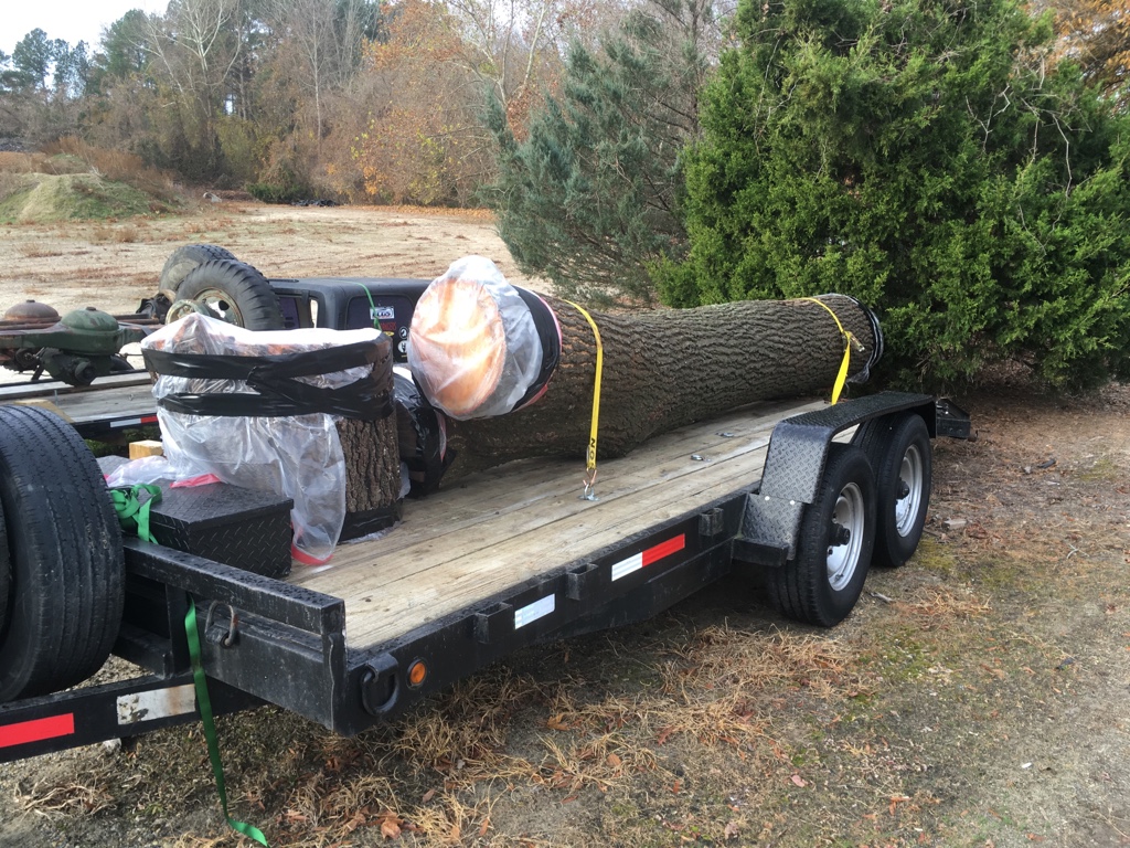

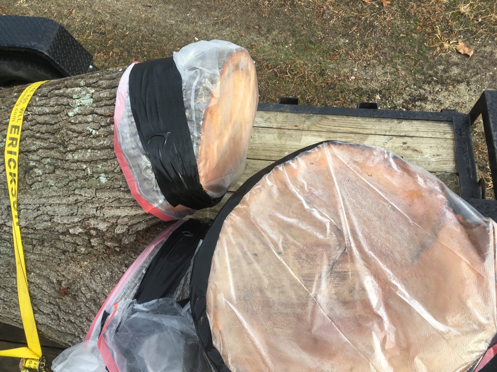

I had trash bags taped over the ends waiting for the anchorseal to arrive.
The forked end was already checking as it was cut the weekend after hurricane matthew, but we will see how my fresh cuts do.
