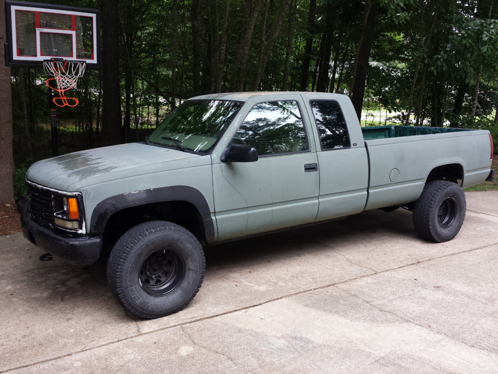

Well, here she is. It has a lot of new parts, new cylinder head and dead gasket a few years ago, new PMD with relocation, new fuel solenoid, all kinds of other stuff. All new bushings in the frontend, 33" tires and new wheels, little lift, runs and drives awesome. Interior is dirty and was a work truck so needs a lot of help, but the body is straight. It was painted with Apache helicopter paint and he gave me some extra to use for touchup.
All said and done I'm only in it for about $1500. :)
