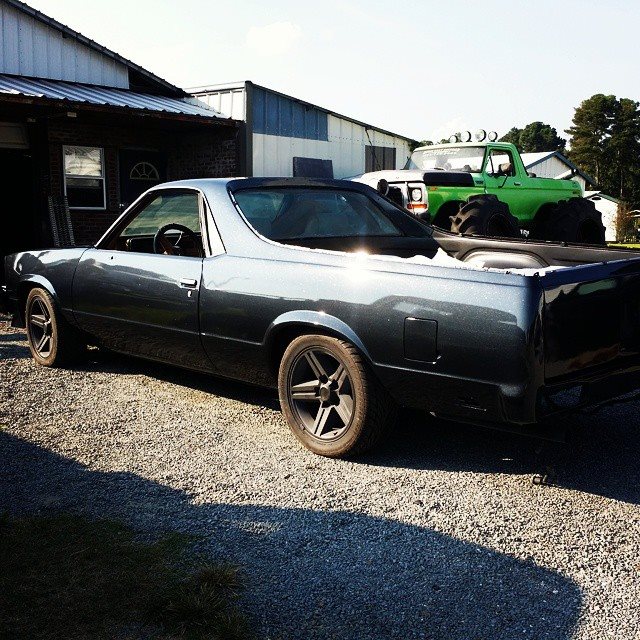

I must of had a brain fart because I didn't even take that in to consideration. My grill is plastic, the trim pieces are chrome(aluminum??), and 2 of them are about 5 feet long. The wheels are also chrome but is flaking really bad.
Don't know if you can really see it in the pic, but its the pieces that go around the bed, front windshield, and over the door
