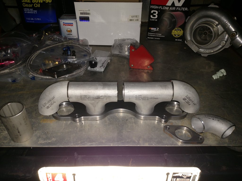

I was being facetious....but you bet your ass that if I'm paying for sch10 stainless bends, then I'm welding them to a stainless flange.
I priced out doing everything in mild steel an it actually came out like $40 more after you got the t's and l's, header flange, turbo flange, and wastegate flange which is why I just ordered this. With 309 wire/filler there shouldn't be an issue welding stainless to mild correct?
The real problem is going to be the heat transfer and cooling cycle differences between the two. Dissimilar metals is a challenge regardless but given the application I would prefer them be the same alloy. Have your guy build a fixture and aneal the set up regardless. Unless you want a sprung pretzel when your done. Welding in equal quadrants would not hurt either. Of you hit that joint all at once it's going to stress and pull the set up pretty hard.

Returned pm, kit looks interesting. All those pieces are no where close to being fit and finish. That is going to require a good bit of fitting up. It would be a good challenge.
