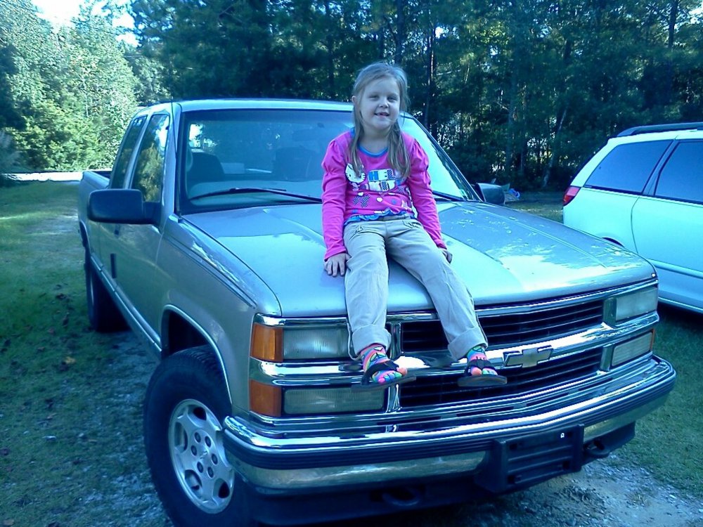

Truck has 235k miles 5.0/305 with manual trans 4x4. Front right fender has been half ass replaced by me, and I have also swapped rear ends from a 98 Tahoe with approx 145k miles on it. Interior is OK but seats are bad and need some attention. I would also say rust is very minimal and has new tires. I am on a very limited budget and looking for opinions. If I were to go looking for replacement it would be in the $3000 to $4000 range. Should I just put that into my current truck instead or buy a car? Opinions Welcome. I could see this being a decent project truck in a way.
