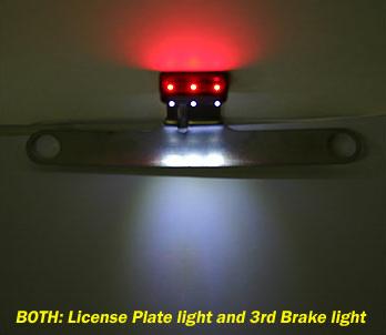

I run one of these. It mounts behind your plate...offers third brake light and light for the plate. Keeps you legal.
http://www.offroadonly.com/Products/LED_Lighting/plate_light.shtml

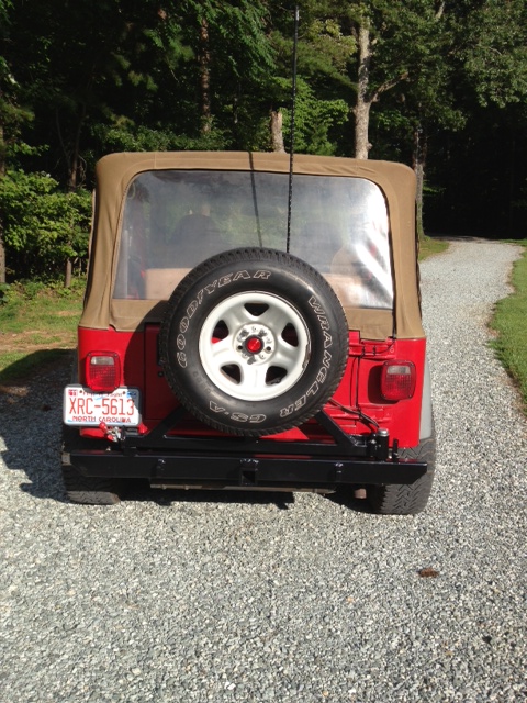

If we're talking a TJ here you should be able to wire up to the factory 3rd brake light circuit inside the back door. If you still have the contact mechanism that makes the connection just wire an LED of your choice into that and mount as you like and you're done. No relays are anything like the blinkers, as the back door circuit is just a brake light circuit. Just get the polarity right on the LED so it lights up. I did this on my rear tire carrier recently using a cheap 2 inch round LED I picked up at Northern tool. Just wired it in and mounted it into a piece of tail pipe using the LED rubber grommet it came with. I mounted in the center of my spare using a short piece of 2 1/4 pipe tailpipe, the thin pipe worked perfectly to slip the grommet lip over. I tack welded the pipe sleeve onto my tire carrier and worked perfect. I thought I had to have it for inspection, if I had known I didn't I probably wouldn't have screwed with it. Was kinda fun to do though.
