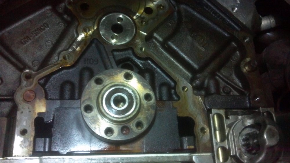

With a short crank motor and that flywheel, you can use the sealed roller bearing that comes in the clutch kit. Looks like this. With the long crank, I went with an LS1 style bronze pilot bushing...because needle bearing on a pilot SUCK.
