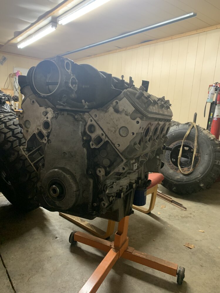

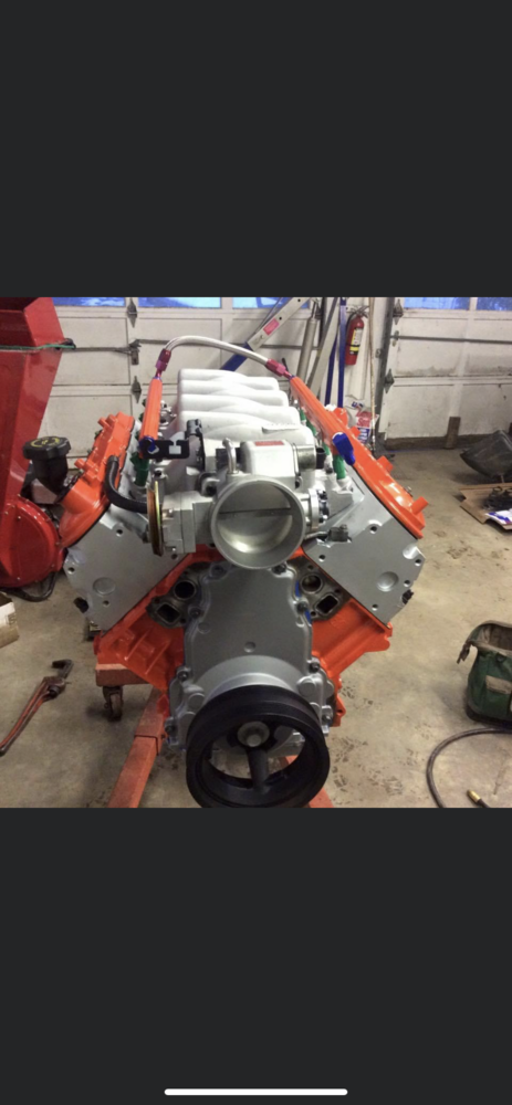

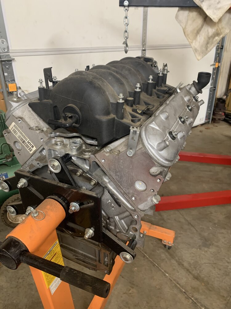

The 5.7 is just what you see in the pics. Not complete. Other motor is complete.
I assume all accessories from a truck would fit it?
In my experience, accessories are interchangeable. The only requirement is that you choose between Vette, F-body, or truck spacing. That decision is determined by your clearance between the accessories and the radiator.
I'd go with the LS1 for the aluminum block.
LS1s have 241 heads. Personally, I'd keep the LQ9, but that's me. I prefer an iron block.
There's something like an 80-100 lb weight difference though.
You do need to pick what spacing you want to run because that determines what crank pulley, accessories, and intake you need to run.
