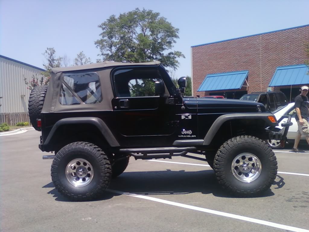

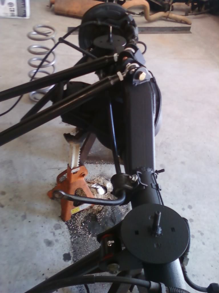

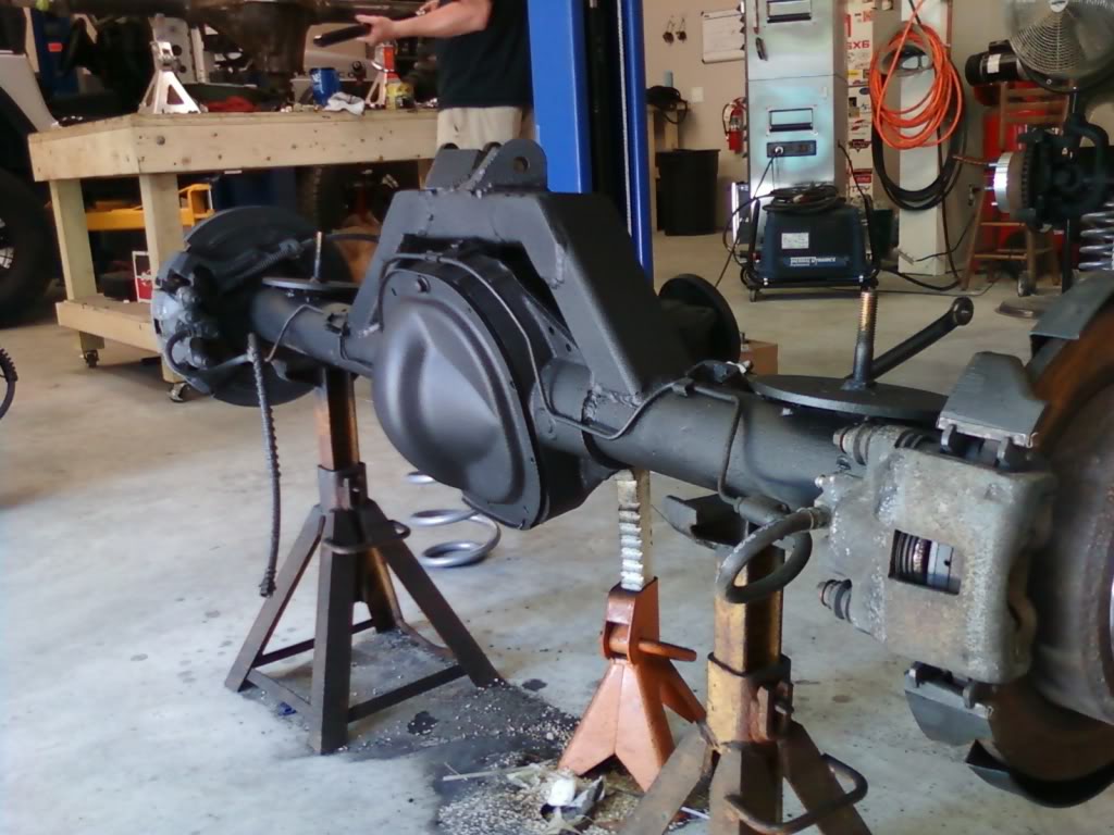

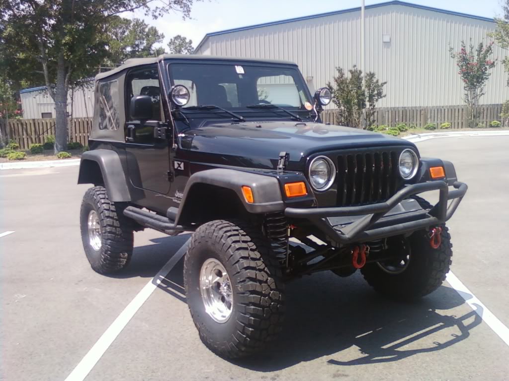

Nothing to special but what we did was 8.8 swap, custom long arms, 5.5" rubi express springs, 4:88 gears, lock-rite front and true trac rear...
we used Balistic Fab Brackets from Carolina Truggies(thanks Alex) for the rear spring buckets/ lower control arm, control arm mounts on the frame and adjustable front trac-bar axle mount...
the rear is a upper triangulated 4 link and stock 4 link front w/ trac-bar...
didn't get to many pics that's why it's not on the build page
tire size is 35/12.5/15 km2 although i think a 36"irock would look great... customer has the wider flairs due to driving up north alot which makes the km2 seem smaller... hope u enjoy
